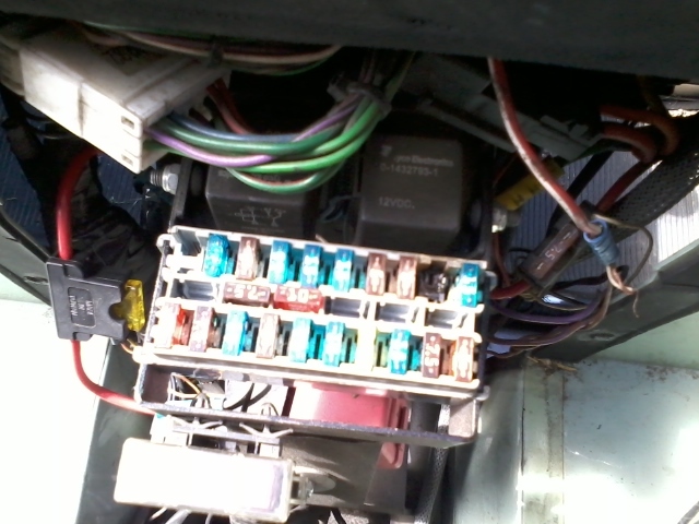

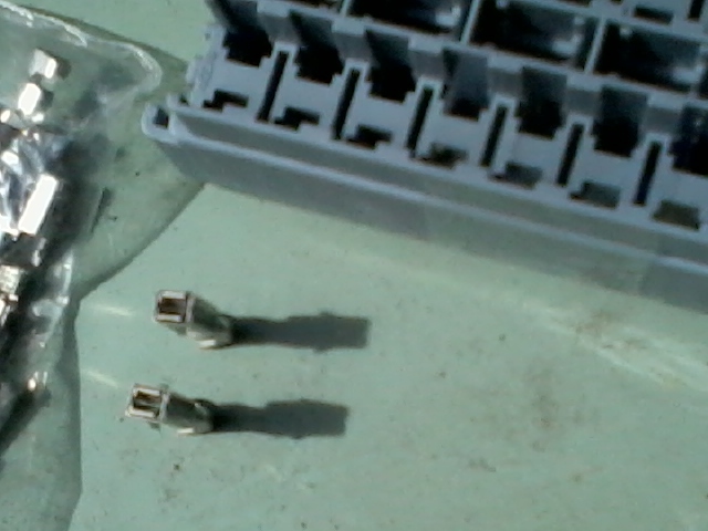

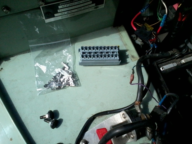

Yesterday my tw does not emit the gasoline pump noise when I switch on the ignition, so I look at the fuse and notice that only the plastic of the fuse has melted and not the metal, by moving it a little it works again and m 'notice that the fuse holder has melted also with the damaged connectors, the wires are too short to re-crimp new connectors so I put a new large fuse holder so as not to have any more problems with walbro.
The original fuse holder with the connectors is on sale at (CAR BUILDER SOLUTION).
