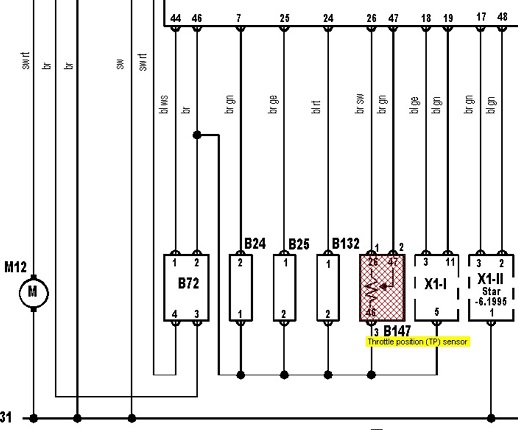

Since the original ‘event’ do you still have 5v on your TP sensor connector?

I don’t know but..... when you shorted 5v to ground you may have put +5v into the oxygens sensor’s reference ground signal pin. Could you have buggered the oxygen sensor?
I don’t know what symptoms a bad oxygen sensor would give on your car?
B72 is the oxygen sensor
Roger

Another contender for poor starting might also be B132, the camshaft position sensor?
(B25 & B25 are the engine and intake temp sensors)
