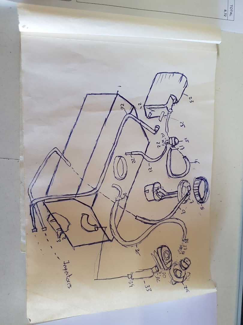

Hello and good morning. Thanks for the help. Everything is different for me. On the drawing you can see. The line goes from the fuel pump directly to the injectors. Line number 10 goes directly to the recuperation tank for the petrol gases. My Morgan has no more connections. I don't understand how this can be possible.
