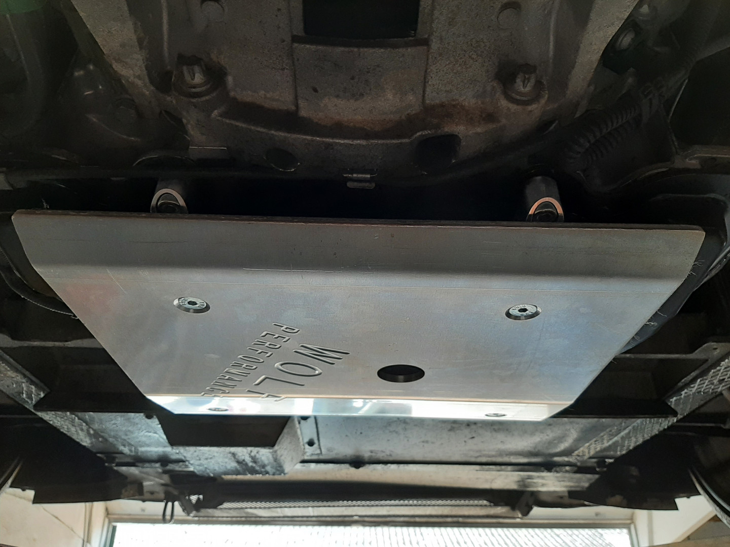

Wolf Performance Sump Guard fitting today!
Cheers, Paul
A sensible thing to do.
I may have commented on this thread already (I don't read through previous pages) but the Wolf guard is an engine saver. I fitted one after going through some mud (yes, just mud, no stones) and found that my engine was leaking oil. The engine is so low and the sump plug so vulnerable - combined with the fact that the engine would suffer catastrophic damage by losing oil...!
The guard is not a bump plate - I think of it as a rubbing plate. Allowing you to pass very slowly over humps that touch the plate.
I would guess the plate has saved my engine from serious sump plug damage at least a dozen times.

Thanks for the feedback on how useful it can be - piece of cake to fit - all done in 35mins! The photographic instructions supplied by Wolf Performance are excellent.
Cheers, Paul

I've just had my sump plate fitted too...

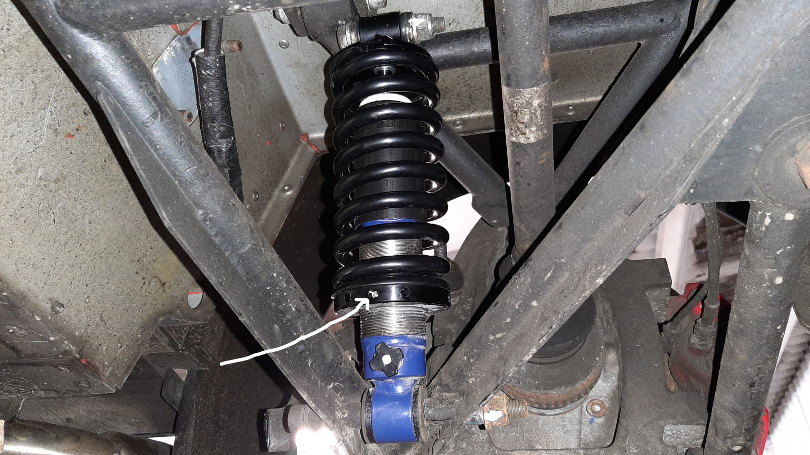

I have a S5 with the SSL conversion and am pretty sure all four shocks can be adjusted for height by undoing the bolt as indicated, marking the position and rotating with a 'c' spanner.
This is well above my pay grade and will be left to a local technician...

Agreed - definitely a BHM job and not for me! Sump plate looking good!
