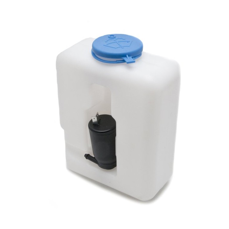

When mine gave up the ghost on my 2009 Sport I bought this set up and used the motor in the existing bottle etc and kept the rest of the kit for spares..
Not the cheapest solution probably but it worked without having to modify anything. I'm a keep them as they came out of the factory man, I don't like bolt on's and stuff stuck on everywhere it pains the ocd in me.

I have found a part that fits the plus 4 GDI washer motor. It’s from motor parts direct, part number PEWP03 and it’s perfectly with no modifications. Cost £8.84. Here is a link in case anyone wants one in the future
https://www.mpdonline.co.uk/product...er-pump-vw-audi-vaux-peapewp03/PEAPEWP03
