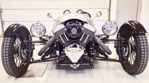

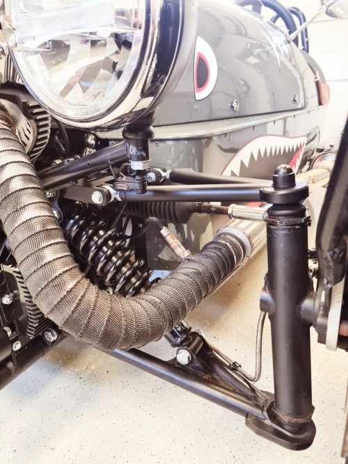

Finally the suspension upgrade and the comfort steering kit are installed:
[img]https://www.tm-img.com/image/3uBEu[/img]
[img]https://www.tm-img.com/image/3uXls[/img]
[img]https://www.tm-img.com/image/3uR3U[/img]
...driving the M3W is really great now ... toghether with the Blockleys it´s a complete new experience!
