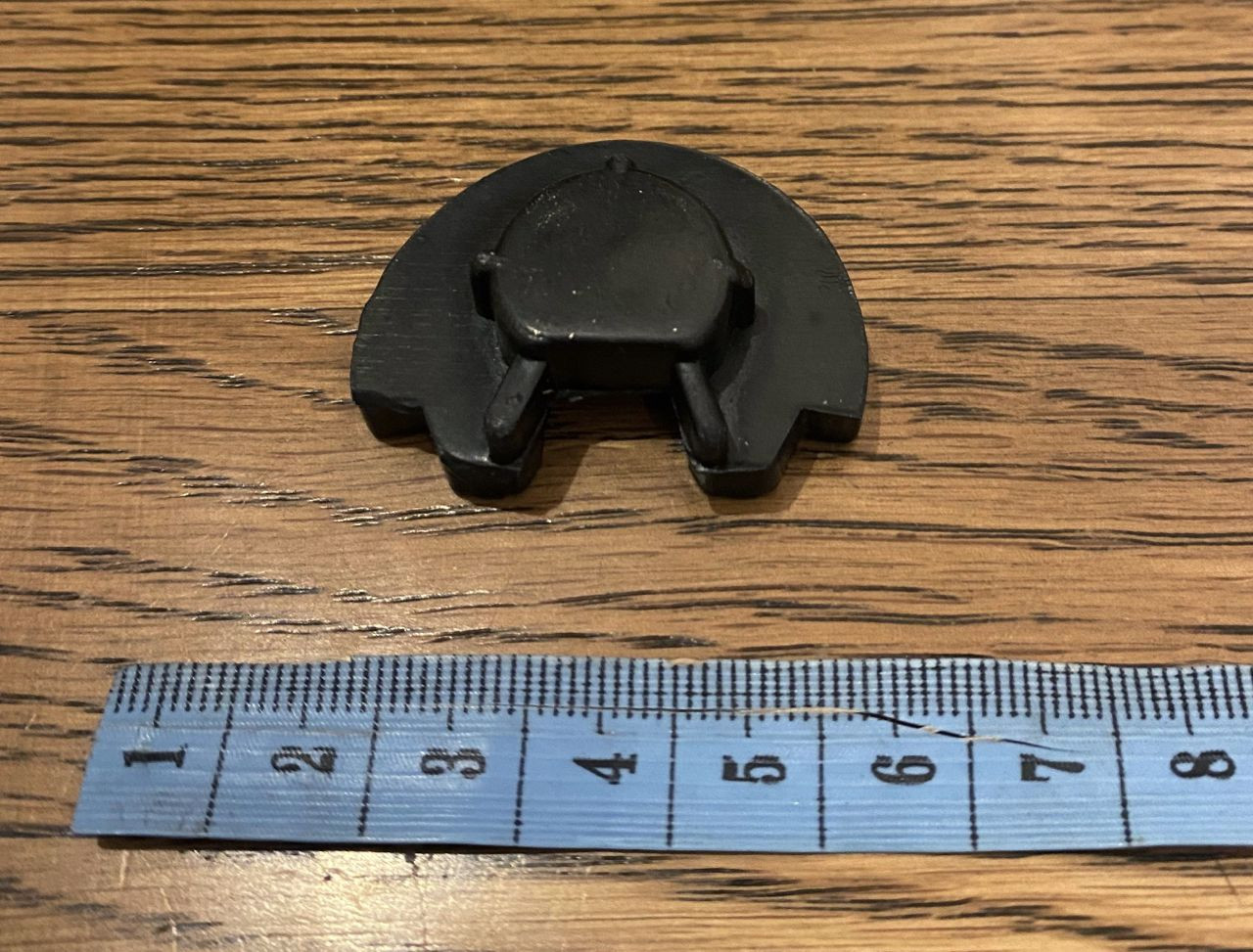

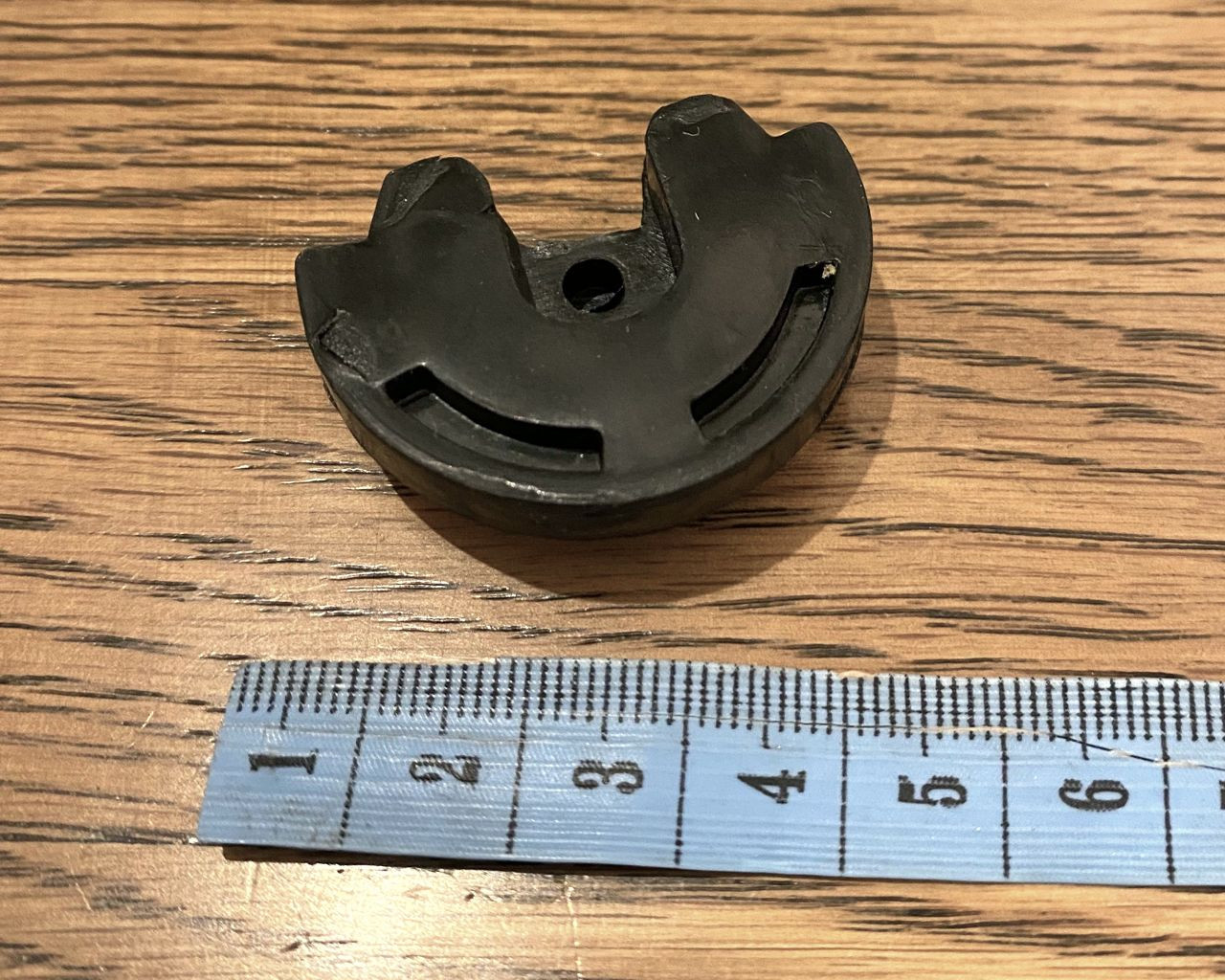

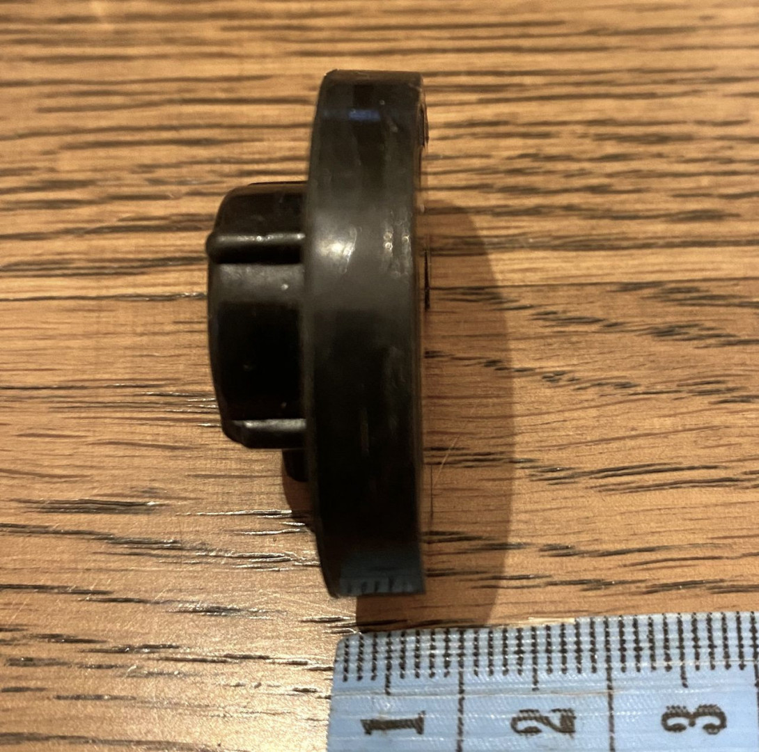

Well it looks the same but the base of the foot is only 6mm so all I can slice off are the bits protruding from the top of it. That is what confused me and still does if I’m honest.

Actually now I’ve looked at it again it is only the 6mm at the bottom I need so it becomes clearer. I’ll sort it once I start the job.

If the rubber part you've been sent looks different to the one in the instructions then would you be able to take a couple of photos so that we can update the fitting instructions? It's possible that Glencoe are using an alternative rubber foot after some people reported that the old type swells up when in contact with fuel. doh

Here are Jonathan's photos of the newer type Walbro rubber foot:
It does indeed appear that it will end up at around the right thickness if just the protuberance is cut off.
