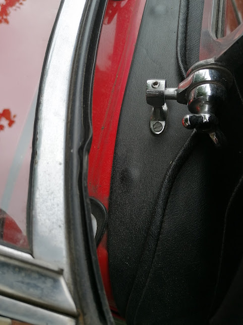

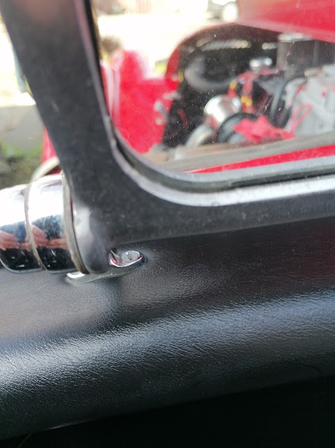

Mine are screwed driectly through the padded dash top. Screws are long enough to bite into the wood - obviously need to drill a pilot through the metal.
They've been on there at least 10 years, and I have regularly run with the screen down in my 30 mths of ownnership
