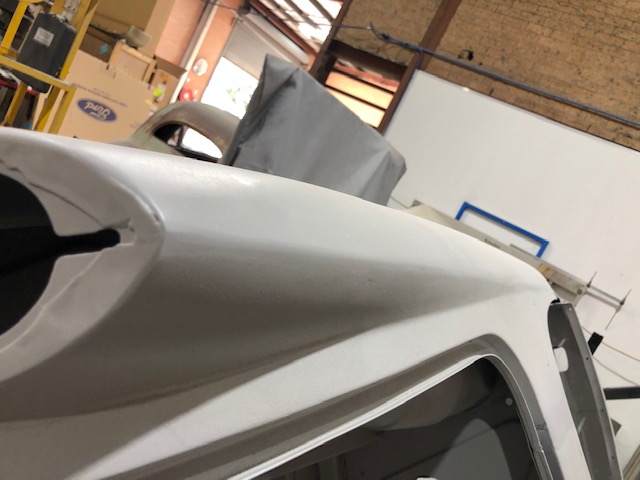

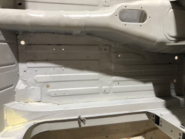

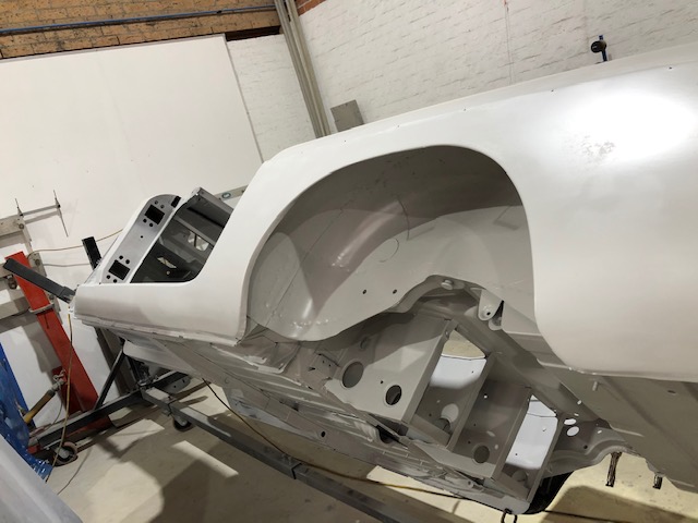

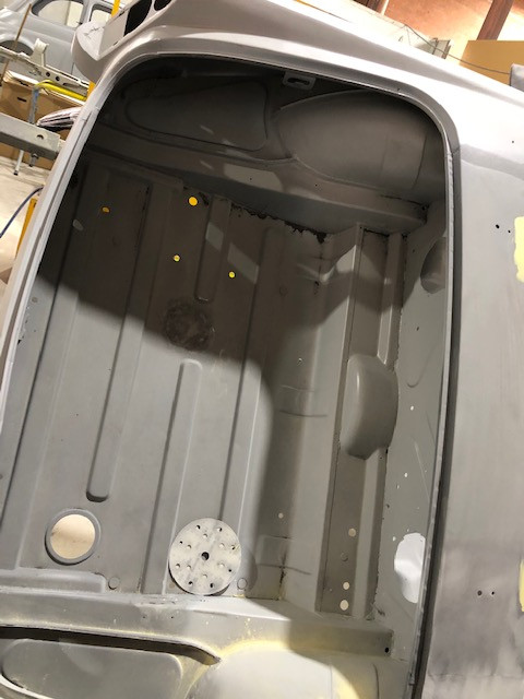

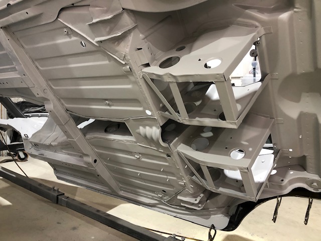

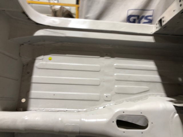

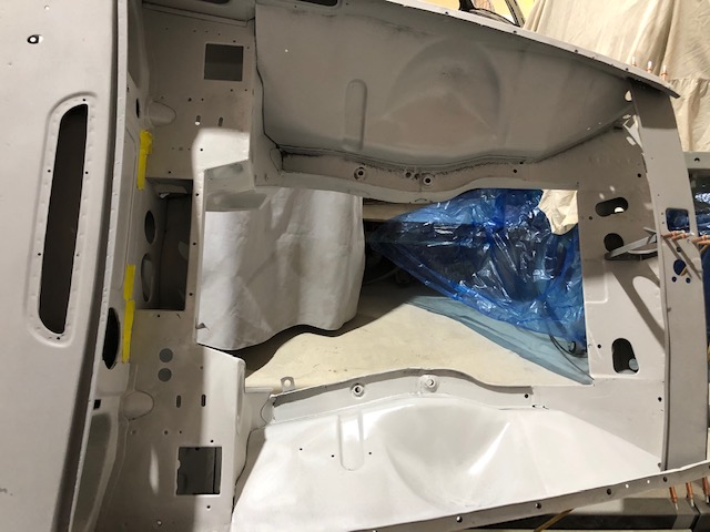

More photos of the body nearing completion hopefully in few weeks they will start painting it.
Underneath looking good but I assume one battery box will be closed in to be used for a speaker.
Passenger sill replaced and seams welded
Rear seams welded
Boot has had spare wheel holder removed, will have no spare wheel and just carry a can of emergency sealant stuff. Hopefully never get a flat
Drivers floor has reinforcing at the back lower corner where the suspension bolts onto underneath, I think still needs seam welding.
Passenger floor looks like it has been welded along the seams.
Engine bay looks like it just needs the front panel welded in, engine mounts have been removed. No progress sine last photos but the rest of the car has progressed

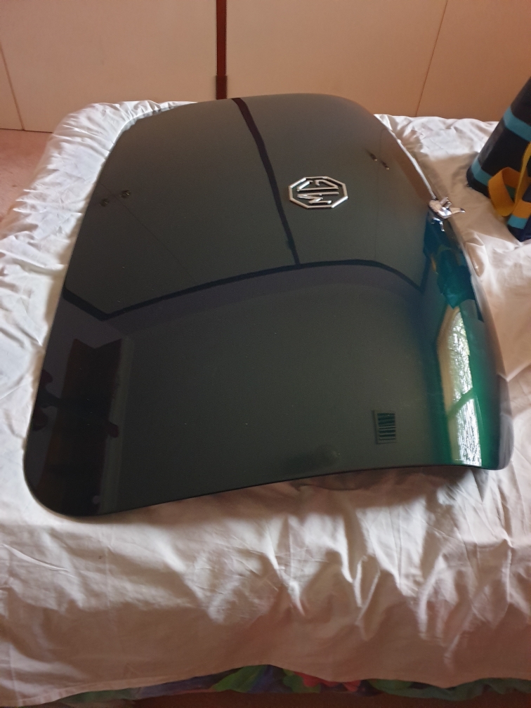

My boot has been painted and looks great.
This morning I signed inside it and by Grand Daughter did a hand print. Those sections will be covered in carpet but easily removed, hopefully the kid safe hand paint lasts. The plan is for the shop to come back next week to pick the boot up and assuming i am happy with the colour which i am they will give the outside a light sand and then spray the whole car in one go. The issue is the workshop is now in a COVID lockdown area so not sure they can visit me. Looks like COVID could potentially delay my car project a bit frown
