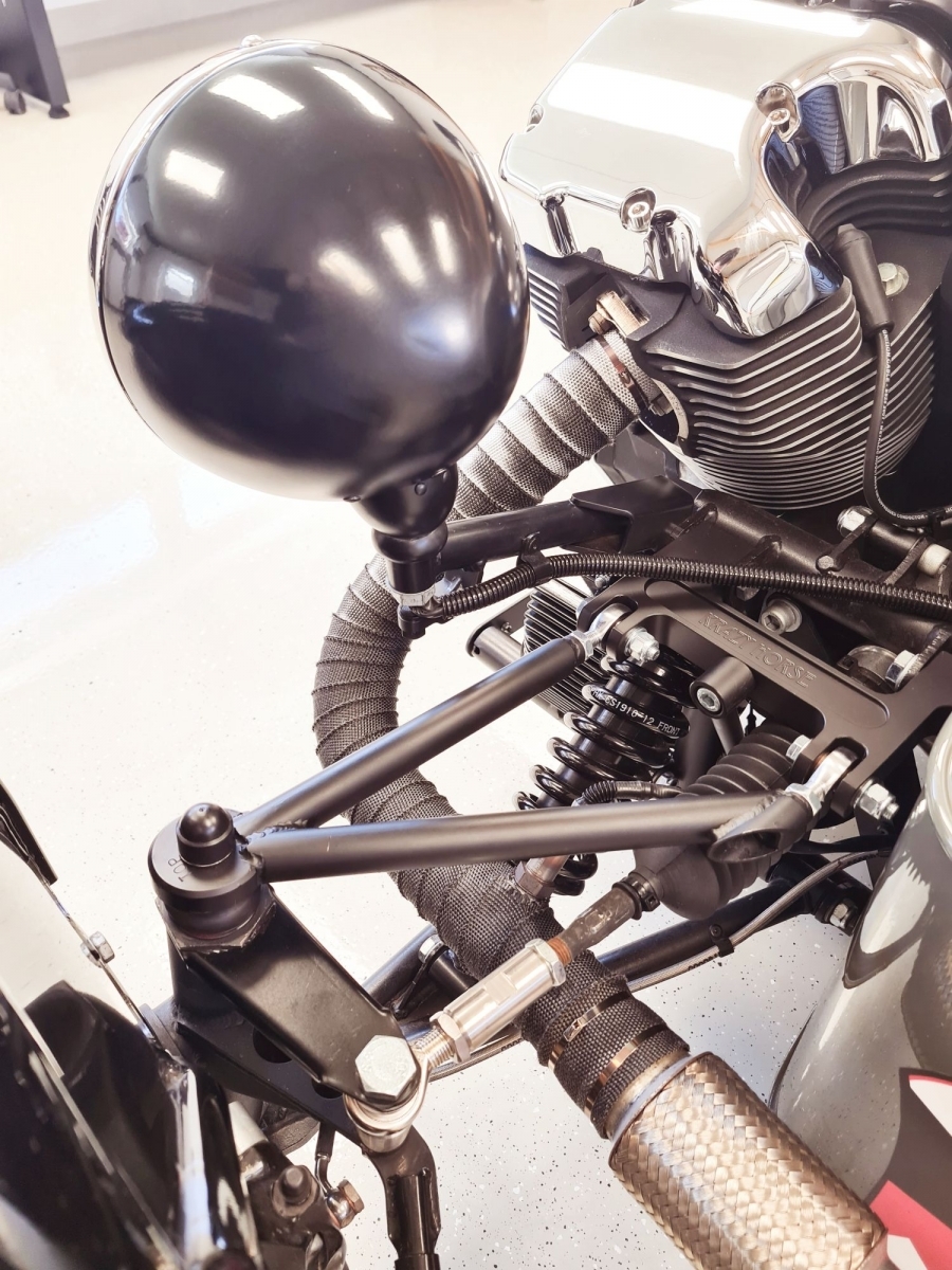

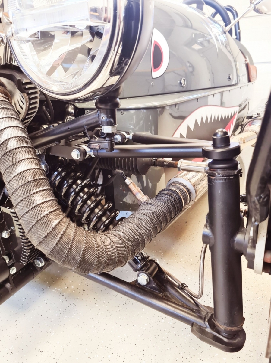

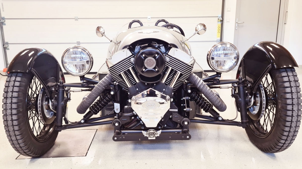

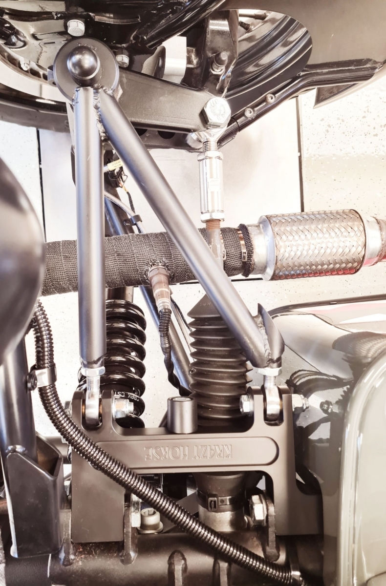

...next improvements:
suspension upgrade from krazy horse - thanks again to Nobby from KH for the great support!
MMC steering comfort kit
MMC urban cooling kit
new position of voltage regulator
...and a lot more you don´t see from outside smile
and finally the best thing - the new wind screen from m3w service in france - version: SPORT PLUS MODEL
If you are interested in the wind screen contact M3W service in france directly
Eddy

... the new feeling to drive the M3W is incredible - fantastic steering behaviour now. The 3 wheeler is doing now exact what it should do and there are no more bumping shocks in the steering wheel during driving on bad streets!

Gosh, driving it must be like night and day compared to before!
As a matter of interest, what are the suggested settings for the Empire kit? I'm thinking particularly of camber & caster settings.

in the instruction manual from KH you find a small range of possible adustment
1 degree of negative camber
6-7 degrees of caster
... and YES - driving it now is a total different experience - in the next 2 months I should receive a set of Oehlins for the M3W ... with this I can´t do more improvements for the driving performance
