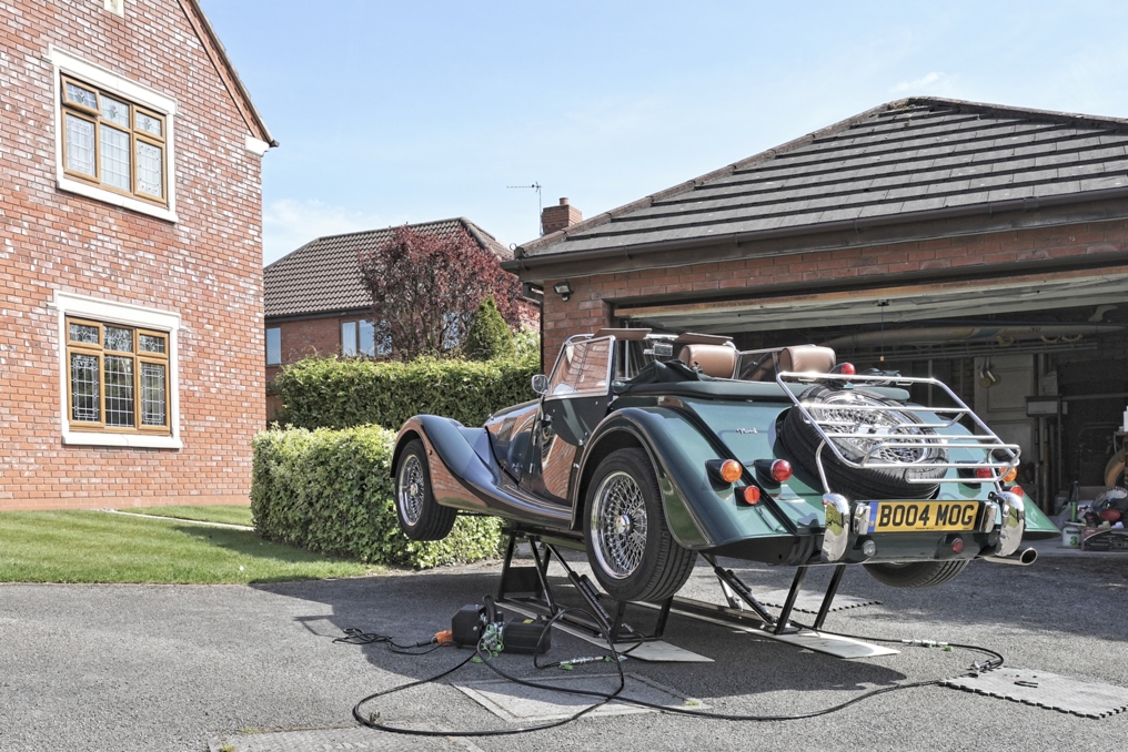

I have plenty of floor clearance too. The lift I use gives plenty of height, and it locks into position when it's fully extended. I can swing on spanners, and hammer and lever things, without fear of it collapsing. It's a great piece of kit.
