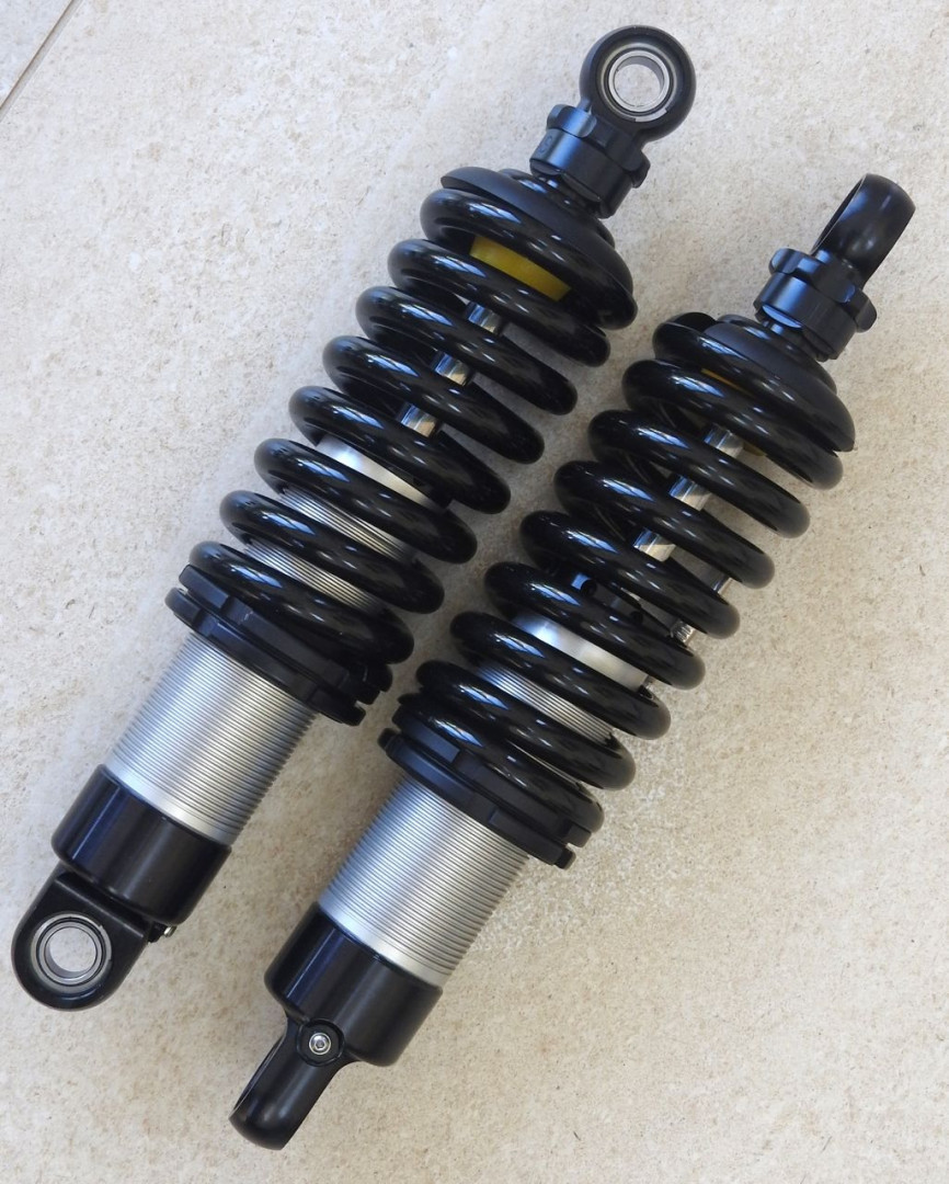

I thought it was about time that ATR shocks had their own thread! For those that don't know, ATR shocks are a premium product that cost around twice as much as Spax adjustables, but half as much as Ohlins. To give some idea, my front pair cost me £720 in Feb 2021. The standard colour is a kind of copper-orange but I chose to have the optional black finish for a small premium.

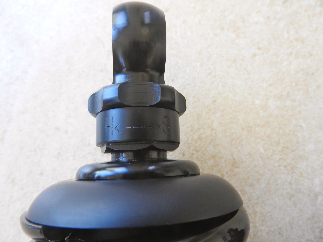

Simple 'Hard' & 'Soft' adjustment

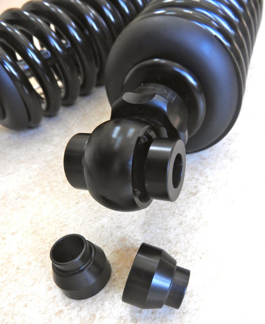

Nicely machined spacers can be made to fit your chassis exactly.

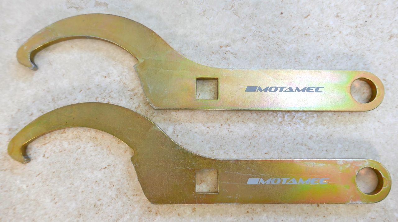

It's also worth investing in a couple of decent C Spanners that actually fit the adjusters - like these: Motamec MT-CSP1-ST, £21 for the pair from Motorsport-Tools.com

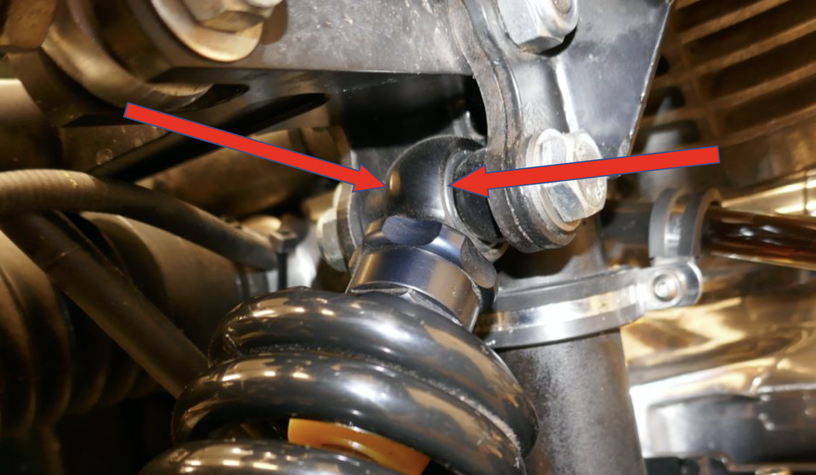

At one stage, ATR supplied o-rings to fit between the bearings and spacers to keep the weather out but I don't think they do any more. However This O-Ring from Amazon seems to work well: 26mm OD x 19mm ID x 3.5mm thick. They come in a pack of 50 and you only need 4 per shock so you will have plenty of spares!

"Keeping weather out" would seem a good idea for an M3W front suspension - excuse my ignorance but where would these go? on the shock's piston?

Either side of the top and bottom bearings.
