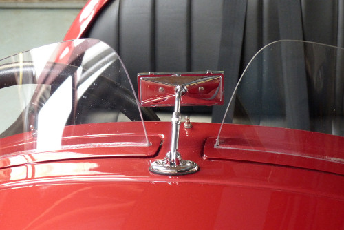

My car has short stalk side mirrors which don't vibrate at all. But the downside is they have restricted vision as the occupants shoulders get in the way. Wondered whether a centre mirror has been used successfully by anyone?

A central mirror is a big help with rear vision I find. I have one fixed to the central support on my Fairbourne screen but there are ones on a stalk mount that work well with the small aero screens as well. Back on topic, I vote for the masking tape fix as well, it works for me.
