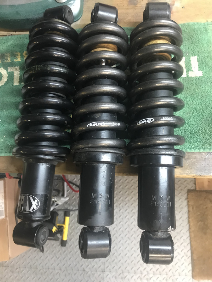

And....in the category of "issues with old car, low miles" (2012) the bump stops --rubber part at top of shock--on my original front shocks turned to powder. Shocks are fine and no reason to switch them (as far as I can tell). Any way to tell if these coil-over shocks are supplex or spax at a glance? And do you know if bump stop dampers are general and work on all shocks? Or do I have to hunt down manufacture? suggestions?

A photo of the two types, Spax on the left and two Suplex. The Suplex should have "M3W S160001" on the bottom and "Suplex" on the springs. The bump stop failure is a problem with the Suplex certainly, the ones in the photo have the same problem.

Okay, my bump stops are yellow. So they must be Supplex. I will look for markings. This helps! Now...if I want to kick this pricey mod down the street, is it work replacing just the stops?

I would certainly check the markings more than just the colour of the bump stops to positively identify what you have. I have no information about replacing the bump stops, other than the contact details for Suplex in the "Parts Sources" section of the Alternative Parts List, available at the top of this forum in the Owners Resource Section. Not sure how up to date that is but I will be interested in your findings about some new ones. My Suplex shocks are sat on the shelf, not the car, so not as urgent. They are worth sorting out if they are Suplex as they are much better than the later standard Spax.

Correction, Ian, mine are SPAX which is marked clearly. I will try to improvise a bump stop or shop for a shock repair kit to keep these going until they start leaking.
