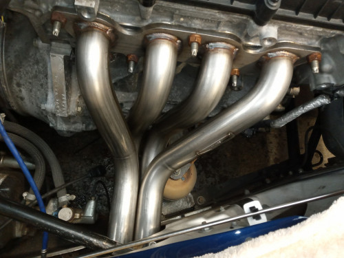

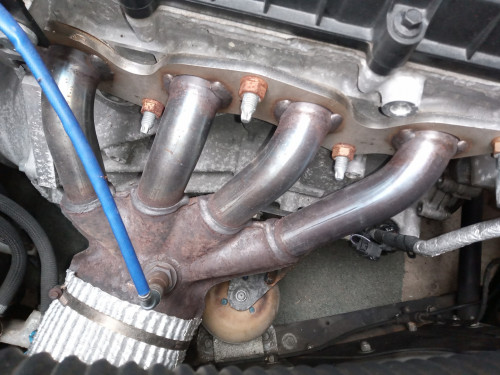

Reading about the significant benefits of a better exhaust system, I considered going the whole hog and getting the AR manifold, cat, silencer and Clubsport map. But reports of substantially louder noise put me off, so I have opted for the Librands/Piper sports manifold and cat, which I had fitted by Matt at Lifes Motors in Southport at the same time as an annual service (he did an excellent job, as well as putting up with me watching/ getting in the way and asking lots of questions).

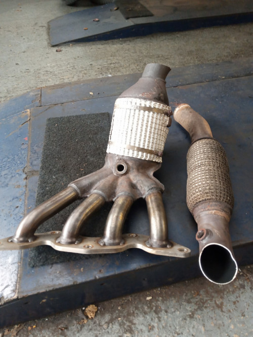

As others have found, the old manifold and cat have to be cut in two to be removed easily:
The results are that the exhaust note is a little louder, especially when making use of the power freed up with the bigger manifold pipe diameters. There are also more pops and crackles. It's nicer to drive with more torque available from lower revs than before and the fuel consumption has improved again, up to around 40 or so mpg.

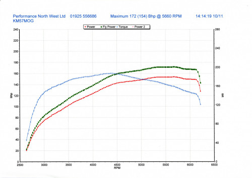

I couldn't resist satisfying my curiosity about the actual power output following these improvements, so took it to a rolling road dyno for a power run, which produced this graph:
Accepting issues around calibration etc of dynos, it is interesting to see the power is around 15bhp more than stock, with a smooth delivery curve - in contrast to some of the other power curves seen by others, particularly with the original basic map.

Originally Posted by DaveW
Oh, and the heatshield from the original Cat will fit the new cat Keith.
Yes, you're right of course Dave. Matt swapped it over to the new one - I took that pic before he'd done it.
