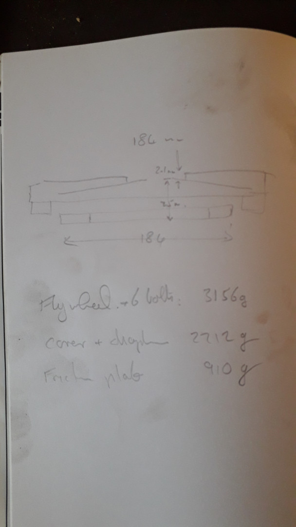

Might you be able weigh your clutch parts? That would let me get a better estimate of the inertia,.

Here is pic of notes i took of weights.
Diaphragm just decided to crack, all by itself.
Had to buy complete new clutch as couldnt source a diaphragm any where
Looks like clutch unit was approx 3kg
Thanks!
That's pretty light all told, and thinning the outer part of the flywheel greatly reduces the inertia, which increases as the 4th power of the diameter.
