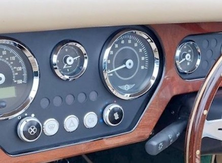

There's a 2019 Plus 4 currently for sale, the photos show the dash with (apparently) a 3-position fan and a 4-position heater control. Was that standard for that year/model, and is the "sense" of rotation (clockwise for more fan or heat) the same for all models ?

That's the Plus 4 GDI dash.
The fan is two speed.
The heater control is just a rotation knob, no specific stops, even though there are blobs!
Picture here to illustrate Dave's comments.
You can just see the pressed steel pinion that attaches behind control knob and moves the quadrant located at right angles via outer row of holes, in turn operating on Bowden cable. The inner row would operate ball detent if there was one!

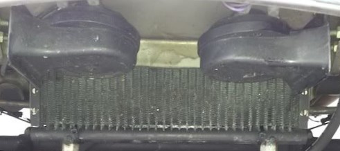

My car does have A/C, but the matrix is at the front of the car.
Peter: If your Roadster has aircon (mine doesn't), you will inevitably have a small amount of condensate appearing under the car from time to time, after a run. There will be a bigger puddle in humid weather. And yes - it will be clear, colourless and tasteless. Where the drain for your aircon is, I wouldn't know - but somewhere amidships I should imagine. Of course - if you don't run with the aircon engaged - the foregoing doesn't apply.
