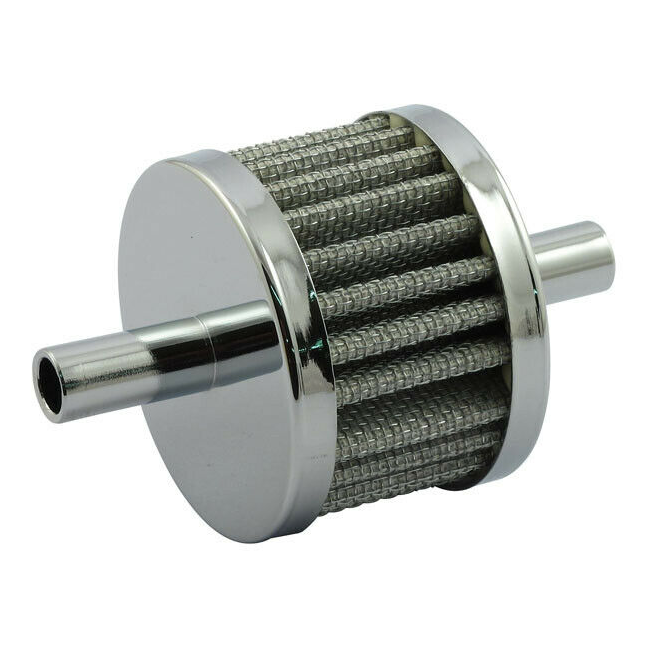

I fitted one of these using a short straight hose into the cam cover, and the existing hose onto the other side.
https://www.ebay.co.uk/itm/143441707435?hash=item2165cac1ab:g:mocAAOSwWl5dzVQk

Dave, I like the look of this Crankcase Breather Filter.
Is this instead of an oil catch tank, something I've held off from as many seem to say they never have to empty.
If its just a simple insert in the current breather sounds like a simple plan !
Tim
Tim
Plus 4 2018
Posts: 22,366
DaveW Offline OP
Posts: 22,366
Exactly that Tim. I had a catch tank initially, but when I fitted the AR manifold it wouldn't fit. So this was my alternative.
And it looks "original" grin2
