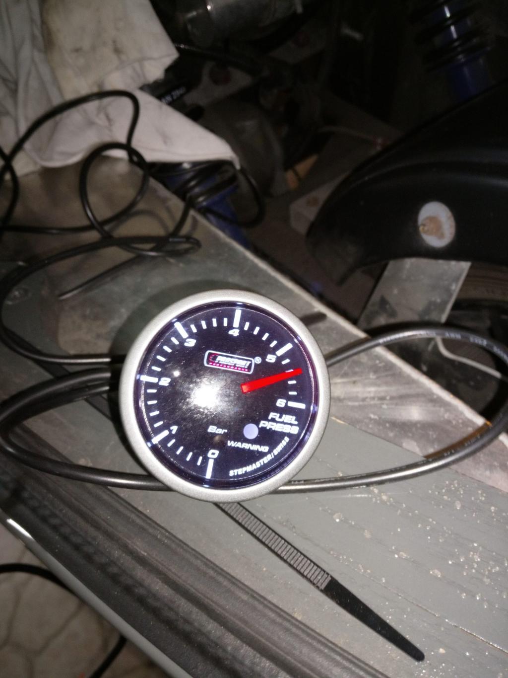

Not entirely sure what I'm looking at but shouldn't the fuel pressure be at 58psi?

It appears that a picture is NOT worth 1,000 words.
It's a BAR gauge which looks like it's reading 75 PSI. If it is really reading 75 PSI, something is very wrong.

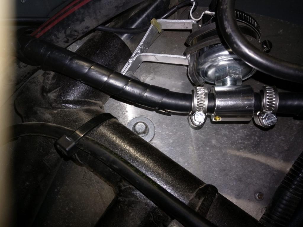

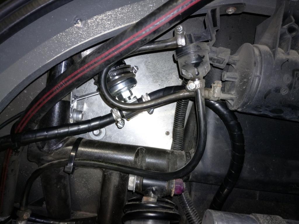

It looks like you have replaced the Mahle KL167 filter/regulator with a regulator that maintains about 75psi, or 5.4 bar. Not sure why you would do that? Pretty sure that the Mahle KL167 will work fine with E10 fuel. Have you fitted another inline filter in the system?

There was no. Change on the fuel Line
There is 5,5 bar And the engine start And run very well
