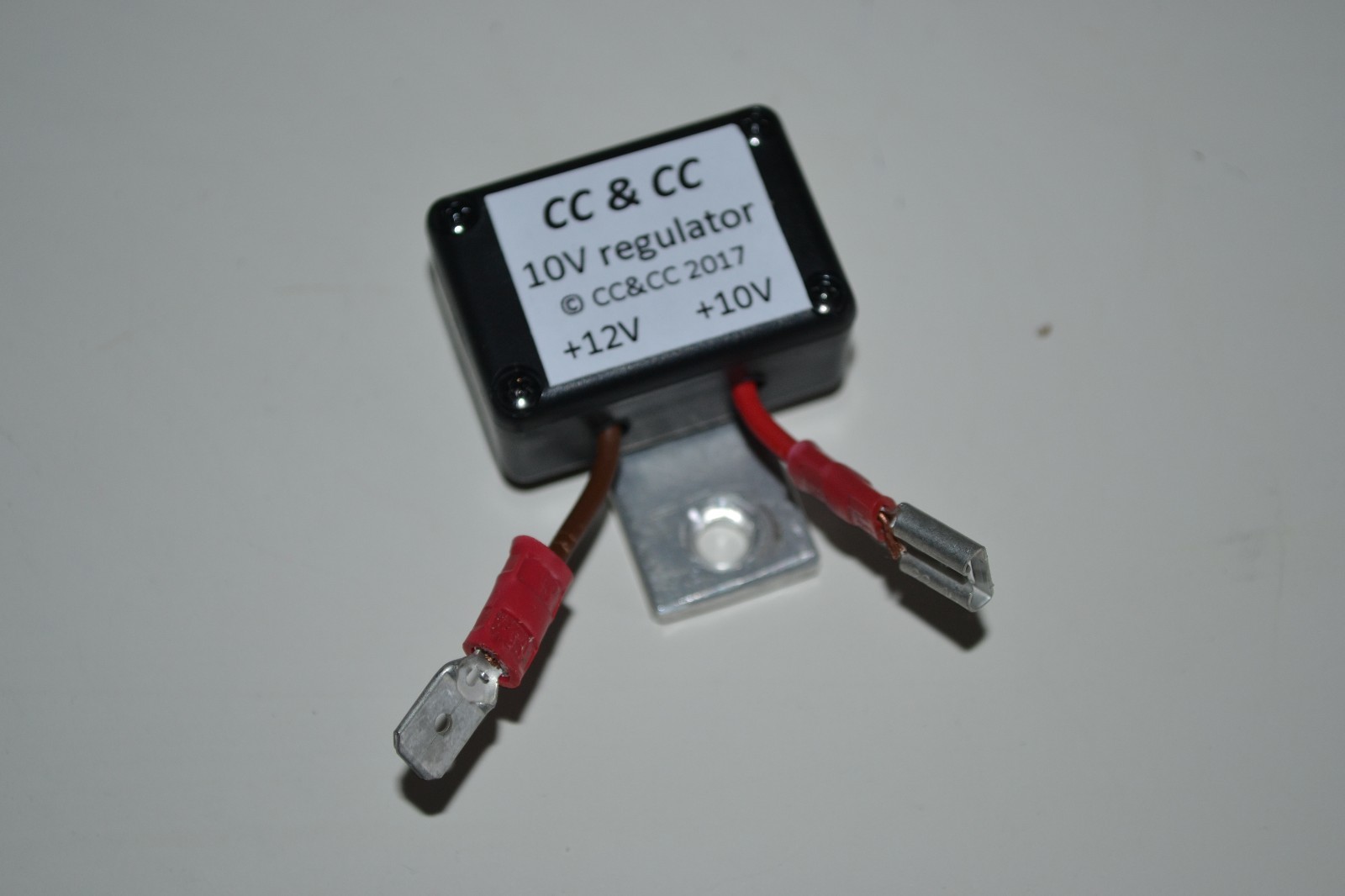

Yep, replaced mine with a solid state regulator - gives me much more accurate temp and fuel readings. Regulator
The chap at Spiyda makes some really useful stuff, very helpful too

Don't forget that if you are measuring the output of the mechanical voltage regulator it won't read 10V but will chop between 0v and battery voltage (12-14V). The fuel and temperature gauge are heavily damped and take an average. The regulator that TBM mentions is easy enough to install as long as you are the size of a 6 year old child!

There are other solid state regulators which closer mimic OE.
