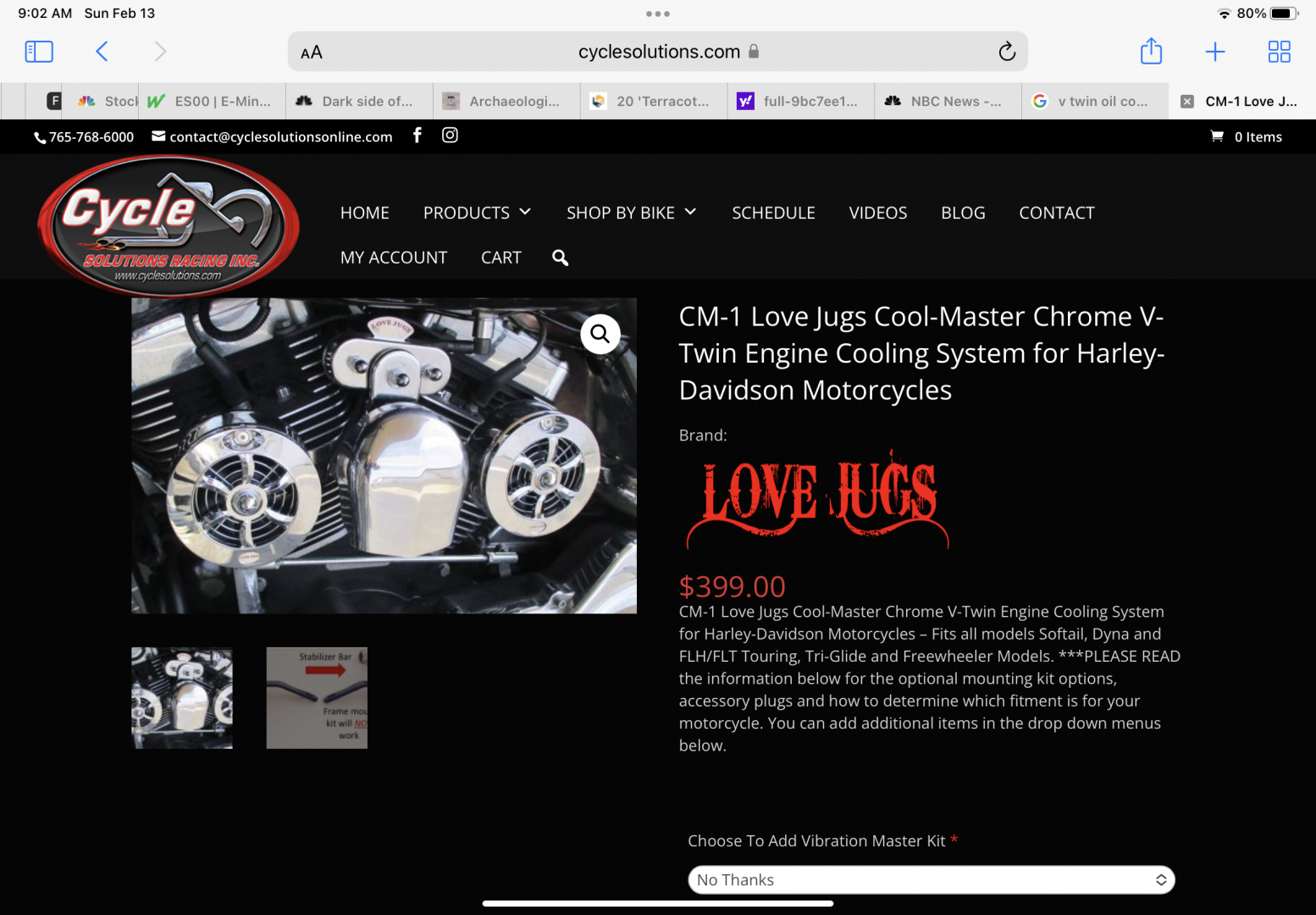

Does anybody know how many amps the stock cooling fan draws?
As we all know the X Wedge engine produces a lot of heat. Even with less restrictive exhausts my engine does not run as smoothly when I’ve driven it for awhile because it still gets too hot. From what I’ve been reading high output fans placed right behind the highest temperature portion of each cylinder is the most effective way to reduce cylinder head temperature. More effective than oil coolers.
I’m considering removing the stock ECU controlled fan behind the engine and installing Love Jug fans hard wired directly to the battery with switch and bypassing the ECU control so I can turn them on as I desire. See pic below. Each Love Jug fan only draws 1.6 amp.
Is there any harm to ECU function if the fans are disconnected from ECU control. Obviously I will be turning the fans on with slow speed driving when the ECU would normally turn the fan on but also after extended driving when I feel the engine is too hot which I can tell by how smoothly the engine is running.
Appreciate your thoughts.

I think excessive engine heat in these big V twins must be an issue. Why otherwise are all these products available such as oil coolers and fans to reduce cylinder temps. As Red Leader pointed out Morgan itself felt compelled to put a fan in the back and top shroud to redirect air flow to the back air fins. I’m wondering if this is enough in my vehicle. I personally feel what is happening is the spark plug electrode and top of the cylinder wall is becoming too hot causing causing predentonation which would definitely create abnormal vibration. I would like to install high efficiency fans I can keep on longer during my drive. I certainly could be wrong. I’m considering installing the next step colder spark plug that would dissipate heat from the electrode faster and watch closely to see what effect this has. If the symptoms improve that would say a lot about the temperature as a causative factor. I’m willing to experiment.

I’m asking about the amp draw fron the stock fan because I don’t want to overload the existing electrical system by installing different fans that might have a higher amp draw than stock. I suspect the stock fan probably draws more amps than the Love Jug’s cumulative 3.2 amp draw.

Sorry but thought I'd explained already Sportster, albeit briefly. You are concerned about excessive cylinder head temps but want to fit smaller, lower current fans and operate them manually. How will these cool your engine better given they appear to be for lower capacity HD engines with cylinders in tandem to airflow confused2
