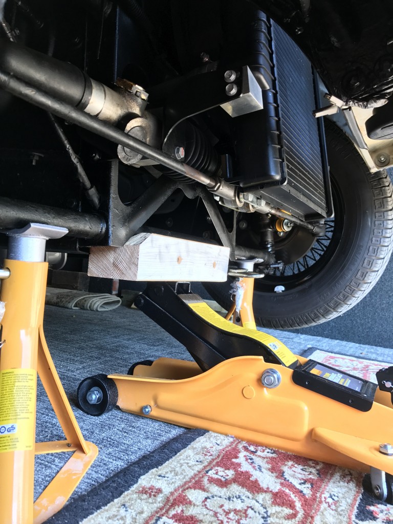

I believe all the alloy radiators sit lower, not by much though.
I have the SiFab radiator, you might be able to see the difference here.

Thanks for this Craig. To me that seems to sit quite a lot lower and if it were not for your valance, the bottom part would be very exposed.
hmmm...
Really appreciate the pics.
