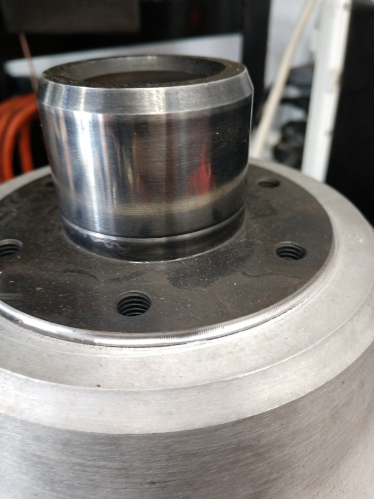

I too thought that I had done my research, and had a plan to make the expected updates, fixes, etc. What I had not planned for was how MMC reacted to unexpected quality issues, with their most common reply to my complaints being, "but nobody complains about that" or “they all do that”. More specifically, their Centa upgrade kit’s main journal was made so poorly, with metal lathe chock marks on the sealing surface, it tore up the rear main seal shortly after that 'upgrade', dumping its oil on the street.
It was shocking that senior MMC leadership had so many stories, excuses, and denials. Although MMC eventually made a journal without chock marks (after I sent them a YouTube video on Metal Lathe Soft-jaw Technique - when they said it could not be done) however, still with a turned sealing surface; which is likely the reason why most leak oil. I then had a race-car shop machine a burnished surface with a chamfered leading edge, as my upgrade to MMC's upgraded part... and it then didn’t leak oil (no, they don’t all [have to] do that).

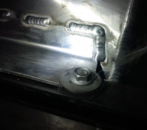

I also don’t think the original book’s edition had anything about fuel tank cracks, which turned out to be my most expensive repair cost, and a design that was never improved upon by MMC. My re-welded brackets,

The bush with the Chuck marks should have been picked up before it was even installed, school boy stuff.
