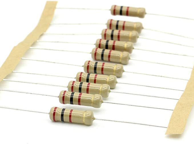

The electrical connection with the Delphi connector is: A red yellow wire B yellow pink C yellow black and I put a 1w - 2k ohm 5% resistor between yellow red and yellow pink, you have to choose the black Delphi connector which is different from the connector Grey. ![[Linked Image]](https://zupimages.net/up/22/35/8obs.jpg) If you choose a sensor with wires I think the connection is black with yellow black red with yellow red white with yellow pink, to be tested.
