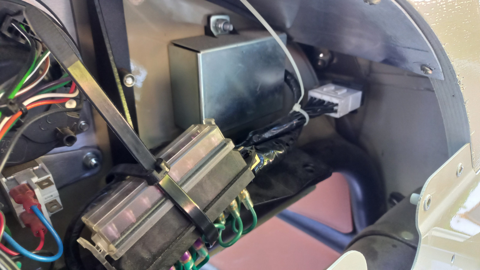

The last photo with the metal box looks like the immobiliser. Follow the wires back, the insulation wrapped loom and you should find the plug. I think Chris and Phil are correct about the loom being black wires as well, from memory. Your jumper plug looks the same as mine, it should work.

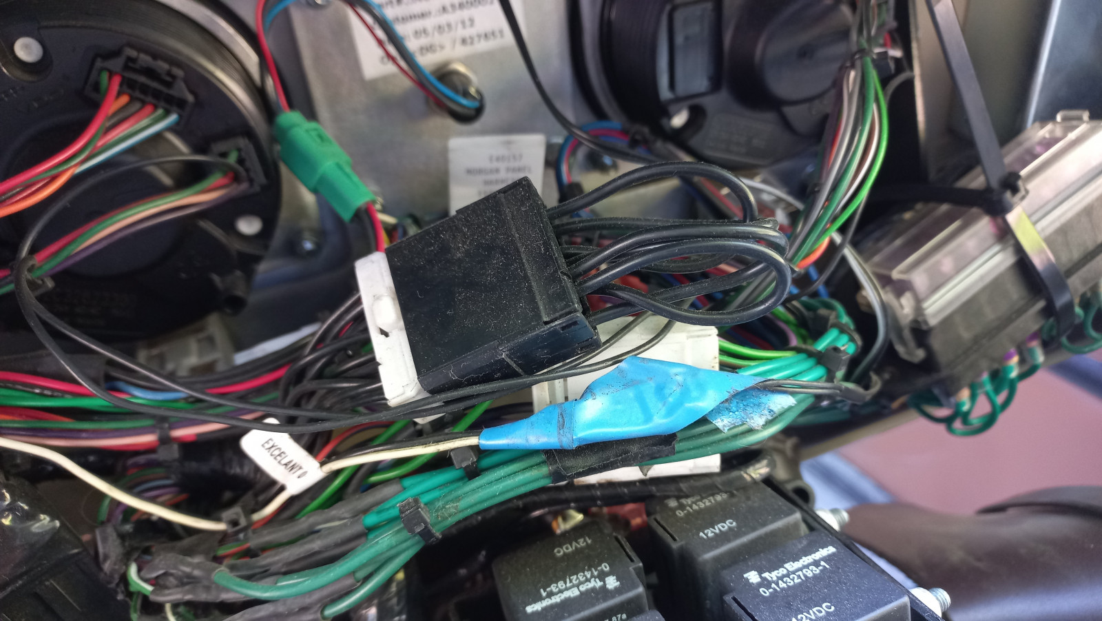

I have done this on my 2012 car.
The immobiliser unit is the silver box, all wires to it were black on mine. I presumed this was to be a bit secret squirrel and make it harder to by pass?
Will post pix shortly
Joined: Aug 2011
Posts: 398
Joined: Aug 2011
Posts: 398
Photos
First shows box and wires and plug exiting box
Second shows blank plug(black) with black wire loom to the white segment.
There is also a pair of wires from the dongle sensor to the box with a connector wrapped in blue tape. On mine this was loose and would disconnect with vibration!
The myriad of green wires and a fuse connector was the solution to mysterious electrical issues including the ability to start motor without key by having emergency flashers turned on? There were multiple inputs to single fuses which are nice routed individually
