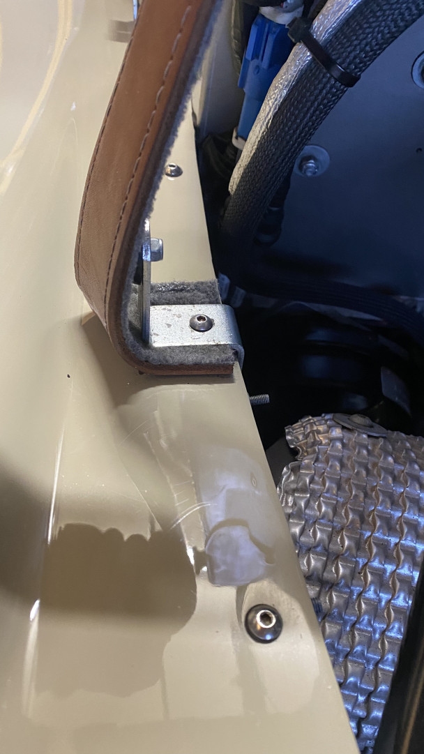

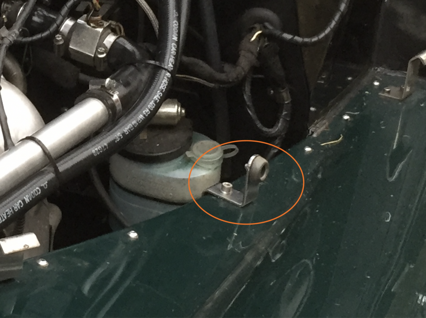

Does someone know where I can get the hardware to put on a bonnet strap ?

As far as I'm aware there isn't any hardware required. You just put the end of the belt between the wing and the little buffer jobbie that sits between the two bonnet catches. Obvs you'd need to drill a hole in the end of the belt to bolt through. I can't illustrate that bit because my bonnet belt is at the bottom of a box at the back of the garage.

Mine ('75 crossflow 4/4) has two little strap loops that bolt through the wing .... not yet fitted my bonnet strap and assumed the strap looped round them and fastened back on itself .... now thinking that they are just a guide to feed the strap under the bonnet snug to the wing and it then bolts to the rubber snubber bracket as described above . Bit of a light-bulb moment as I wasn't looking forward to sewing through the nice stout leather straps I'd got 🙂👍

I hope this picture helps
