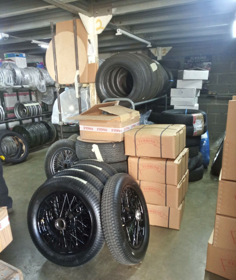

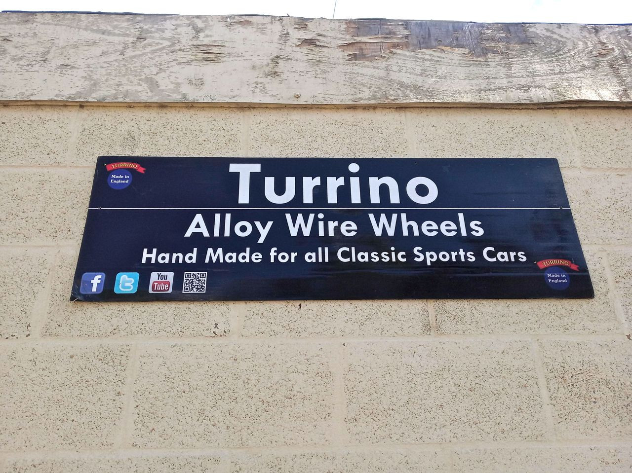

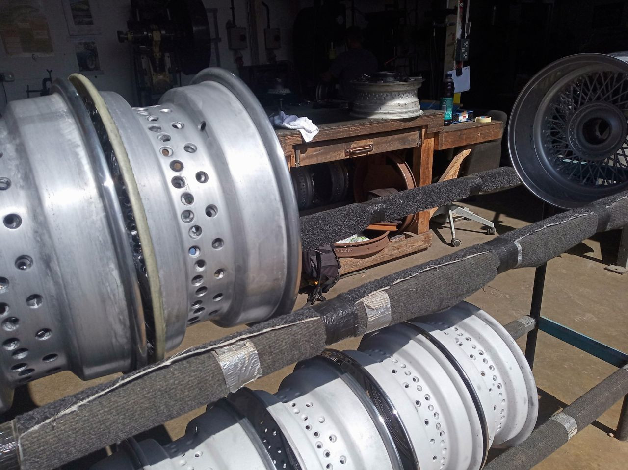

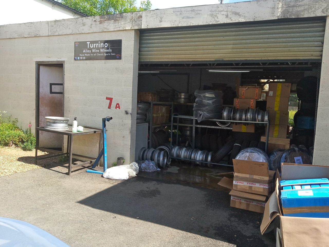

They are wheel specialists and are happy to take on any any challenge.
Considering the high-end product, Turrino operate from very inauspicious premises!
