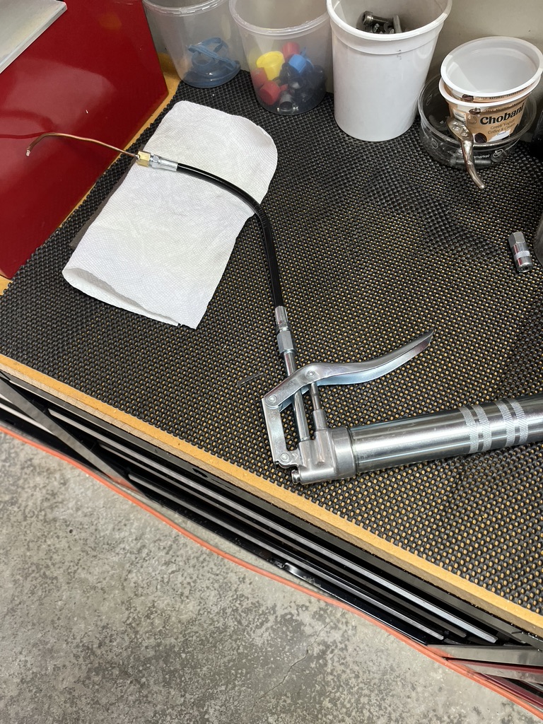

Mine started coming apart early, maybe 25000 miles? There was a slight vibration that encouraged me to look into the bellhousing hole with a bore scope and what I saw was no chunks.
This photo was taken at 4700 miles when I pulled the engine to do the Bleazey mod.
Only one roller had come apart but not completely.
I found after installing the Bleazey roller that the clutch take up is different and more positive. After driving 500 miles on the Bleazey rollers the clutch take up seemed to be a bit more bouncy so I shot some lube into the roller pockets and the take up is smooth again.
This allowed me to inject lube into the center of the roller pockets without having to remove anything.
