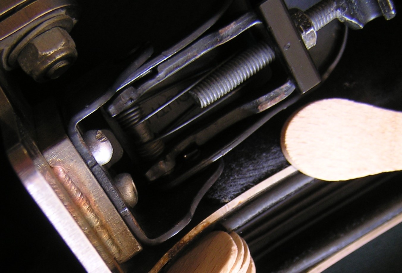

On the easy-up hood on my 2009 Roadster the adjuster screws into the bracket, and is secured by a single locknut on the outboard/lower side of the adjuster (this is a cropped photo, so the resolution may not be very good). Is it a different arrangement on your 4/4 ?

Mine looks the same. The nut I am on about is top left in your picture.
