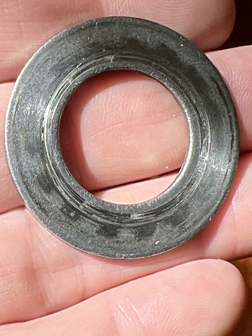

As we all know, in the beginning, our M3W’s had the HD compensator, which didn’t work well due to the lack of lubrication as this construction is designed to run in an oil bath.
MMC needed to find a solution to this problem.
Probably they contacted the engineers at Centa Couplings Germany (the leading company in the world for transmission couplings (see their website www.centa.info). Centaflex-R looks similar to ours.
But Centa was limited in the shape of the solution due to the form of the bell housing-splined crankshaft-clutch etc.
On top of that came the heat inside where the coupling needed to do its job
(we all know what the heat can do because the cam belt also couldn’t stand the heat, and after the ventilation slot in the cover, the belt problems were 99% solved).
The original Centa rubber rollers probably can’t stand the heat as well and break up after a while due to the high temperature.
MMC and Centa didn’t foresee the problem of rubbers breaking up.
And it is a real problem as it’s impossible to change the rubbers without taking the engine out.
Phil Bleazey came up with a perfect solution to easily change the rubbers by turning the Centa and making a giant hole in the bell housing.
He also designed new rollers which wouldn’t break up as quickly.
This is what we now discuss in this treat: why does the big crankshaft nut come undone?
Is that because of the stiffer / smaller rubbers or not?
Now I’m going to give you some more thoughts.
Centa designed the unit in a way that it’s locked on the crankshaft by a HALF NUT - A STAR WASHER and a FLAT WASHER.
When watching the videos from Phil, he stated clearly that the flat washer combined with the star washer is stupid. As it ONLY holds the nut in place against the flat washer. This all looks correct what he is saying.
But that’s only correct if the underlying piece absolutely can’t move! Not a thousand of a millimetre.
Let’s assume the tight fit of the splines is never 100% possible (in that case, you would need to put the part on with a hydraulic press).
So there will always be an extremely slight movement (thousands of a millimetre) from left to right (turning wise) from the Centa over the crankshaft.
This flat washer allows the Centa to do that, as this doesn’t bring this movement over to the star washer and the nut.
That there is movement, you can see on the picture, which shows the imprint of the Centa splines (you see the light polished footprint of the splines, which means it was rubbing as this gives a shiny surface).
As we take this flat washer out, this slight movement will be transferred from the star washer to the nut. And undo the nut.
With only the flat washer, this slight movement will also be directly transferred to the nut.
Because Phil delivered his upgraded Centa with a FULL nut, we don’t have enough place to use the star washer and the flat washer.
On top of that, if we use now as well stiffer rubber rollers, the shocks between the splines will be more violent and have more impact on the star washer and nut.
This will result in the nut coming undone more easily.
I’m not an engineer, and I don’t say all the above is correct, but in my opinion, changing the rubbers and missing one of the washers could be the culprit of the problem we created.
Food for thoughts?
