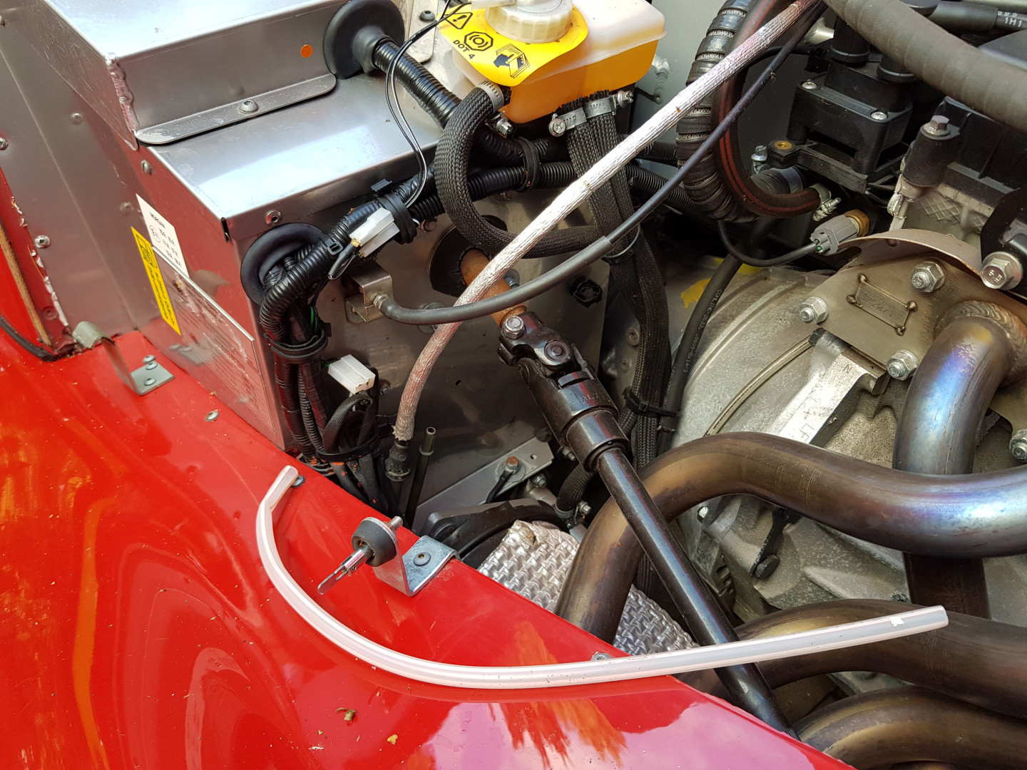

Thanks John, had a look and as can be seen in the photo looks ok (I'm mechanically inept) but found wedged an 18 inch plastic tube not attached to anything though looks like should be attached to the pipe you can see in the middle of the photo (if it's loaded)? The plastic tube has split and have no idea if this is realted to the clutch or not?
