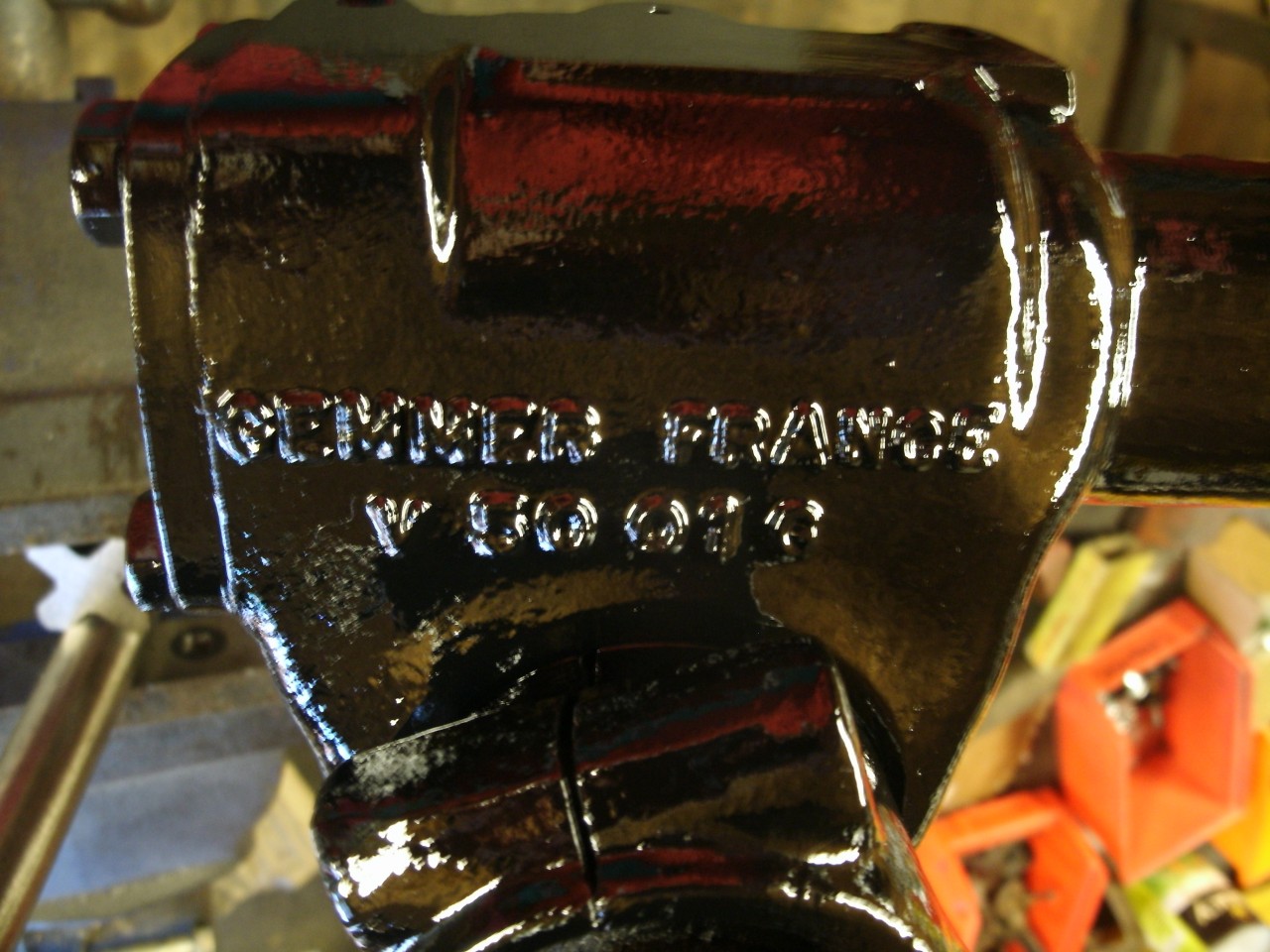

Please can anyone advise the correct oil for the Gemmer steering box on our car?
I think the recommendation in the handbook that came with the car refers to the earlier box.
Thanks

I'm by no means an authority on this subject but in the past I used Millers Vintage Worm Steering Box Oil in my 4/4s Gemmer steering box with no adverse effect

Is it Gemmer or Gemma ?

Ah,so it is Gemmer !
