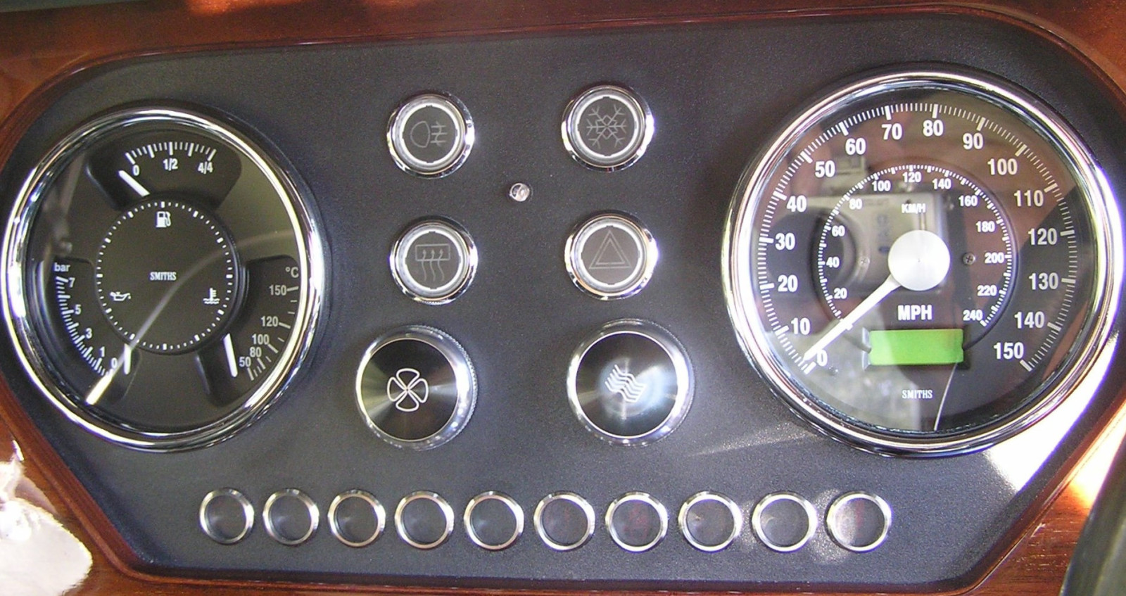

Apologies all, got my symbols mixed blush
This shows correct ones as described by JMcL.
So Dave's image is rear fog top left but what is top right in set of four switches?
BTW the rear fog switch is momentary Dave as it provides a latching trigger to the PCB allowing rear fog light when headlamps selected.

Top right is the “redundant” air con switch. Works as per my previous post.
Yep, and here it is on my Roadster which has A/C.
Thanks for clearing that up thumbs
Can I assume it's a momentary switch as well?
I'm guessing that all four switches interact with the PCB to provide logic switching.
It still begs the question where do the factory fit the optional front fog/spotlight switch on a 2012 car.
