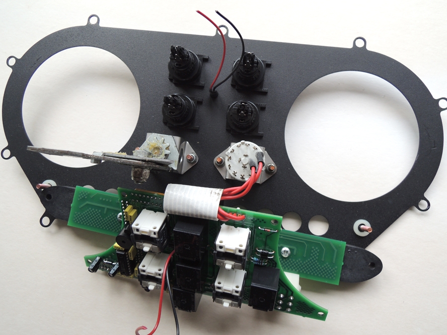

Originally Posted by Montegue
When I looked up from underneath all I could see was the PCB allowing zero access to the back of the gauge panel, I can now see it's mounted to the panel on two studs so perhaps the way to approach this is to undo the nuts and drop it out of the way?
The PCB is mounted on the back of the four EAO switch assembies. There are little plastic interlocks on the back.
These images are from the tm gallery, courtesy of Jays
Roger

Oh jeez Rog, that looks more involved than I thought frown
I'm now thinking if I want to fit my toggle switch in one of the higher positions, I really need to drop the dash to remove the whole PCB.
However, if I remove the two arrowed nuts that secure the telltale light panel.
It looks like it'll move out of the way on its ribbon cable to allow me to safely fit my fog light switch in the central but lower position indicated by the red star above, and shown below.
The contacts on the back of my fog light switch would need to sit under the ribbon cable, but it looks like there's enough slack in the ribbon and room under it to allow for that? To fit the switch, obviously I'll be drilling into the front face of the panel so I'm super keen not to drill into any delicate electronics, I need to make 100% sure anything vulnerable is safely right out of the way to completely remove all risk of expensive damage.
What do you think of the above approach and this lower proposed position for my amber illuminated Durite toggle switch?
