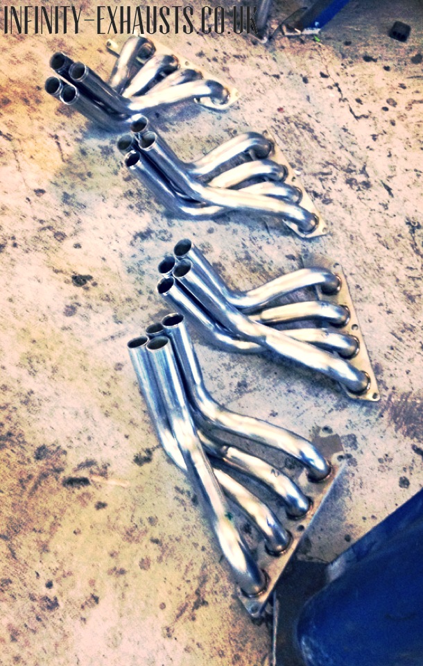

Better still, this is the rather nice looking Infinity Exhausts manifold
