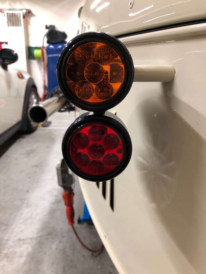

I too added extra indicators and tail lamps to mine, both led lamps from the same source as MMC. They appear to be identical in appearance and operation.
The bottom lamp is added with the removal of the reflector.
