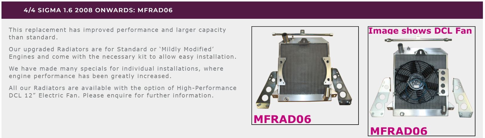

Here is the link to the radiator installed:
https://www.mulfab.co.uk/products/aluminium-4-4-radiators/
