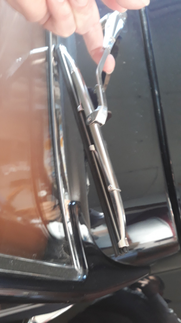

here is the model for my 2020 plus four:[Linked Image]
