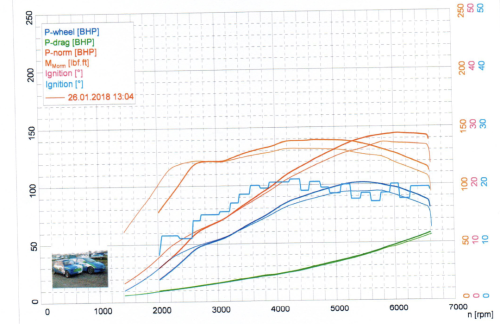

My humble opinion. A moderate increase in power is what you can expect from a naturally aspirated engine mapping, nothing more, if all parts remain the same such as the exhaust manifold or the camshafts. On the 4/4 Sigma, surprisingly, more power gain was seen, but only because the standard mapping had reduced the possible power of the engine, especially the torque was less than "by nature". Before I had the mapping done, see below, however, a sport manifold was installed
