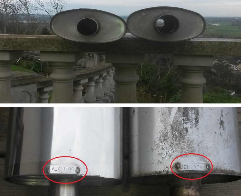

It might be worth checking the part number on your silencer if it’s a Morgan item. My first car had an engine vibration spot somewhere around 3K rpm. The engine was very smooth either side of this narrow rev window. Motorway driving was a pain as you had to avoid this engine speed at all cost otherwise you risked losing your fillings. Could feel it through the steering wheel and body rather than any noise. I did a lot of investigation but traced it back to a resonance in the silencer. It was the straight through silencer part number MEX 1107. I swapped it for the baffled version MEX 1105 and the resonance was gone.

Cheers Rog,
Brilliant, I'll do that. What a useful knowledge base forums are.
Can you see the numbers with the exhaust on the car, or will I need to remove it?
Apologies, I would go and look only the car is back in storage.

Depends which way the number tag is facing. No problem if it’s down but if it’s up you might be able to read with a little mirror.

Here's a picture of the complete system I removed Stephen. As you can see flared fitting front, cat end, plain fitting rear.

The silencer on my 2011 +4 is MEX1107. That came with the car when new and from what has been said, it is the straight thro’ version. The identifying number plate was on the front, facing towards the road, so easy to read.
