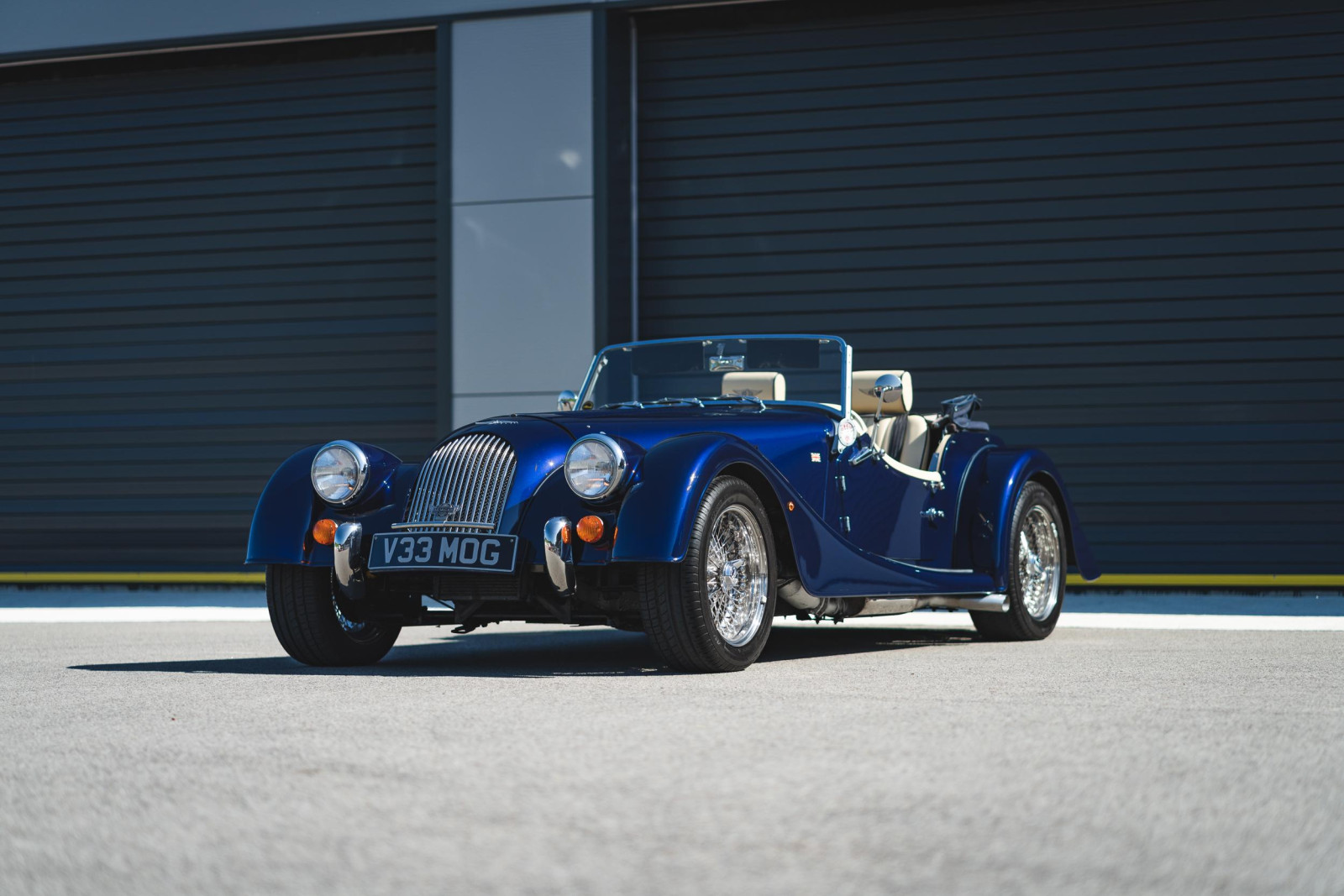

This is a beauty with lots of sensible performance enhancing work already completed including a good sound track.
