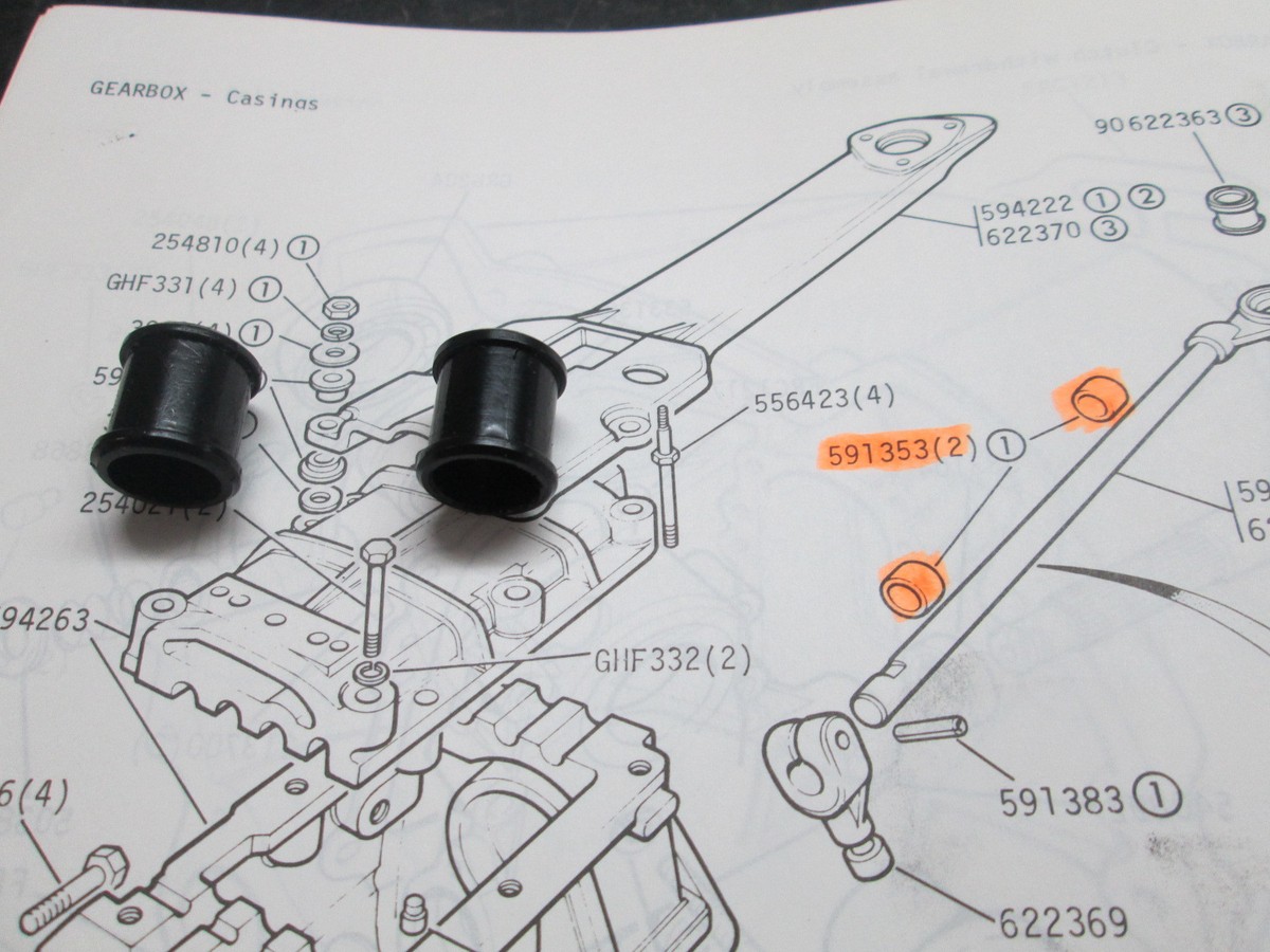

Might these help?
Click for source. The same 4 speed Rover box was used on a variety of P6 models including beefed up version for 3500S. I'm assuming they used similar gear change linkage though.

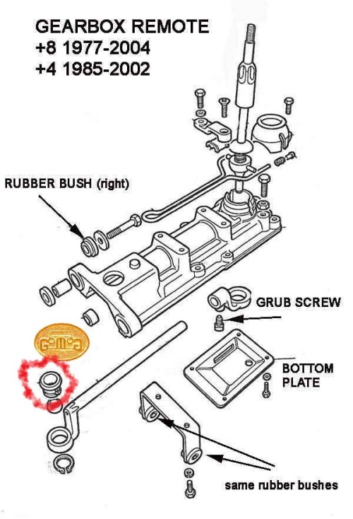

May I help? The cars that used these failing bushes are listed in the diagram. All others are different. Calypso has the right gomog diagram but is pointing to the wrong place and component. The guilty bushes are indicated by arrows to "rubber bushes", also known as plastic or rubberized plastic.
The bush part numbers are UKC854 (origjnal) or in neoprene (advised) UKC854POLY . Colors of the poly will vary depending on who you buy them from. The Land Rover people began coloring theirs yellow when the demand for them became akin to a plague. Simply google these numbers for suppliers and pick the price or color you wish.
