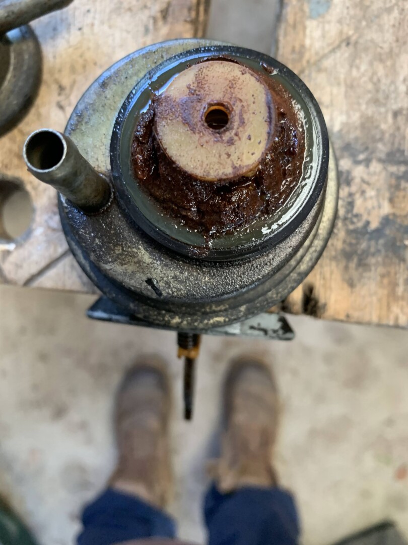

Morgan owner for 6 months or so. First the Gearstick issue where it came away in my hand while driving her home - fixed. Intermittent electrical issue, which is still not definitively fixed, but I am getting closer (I think it is somewhere around the ignition key). Latest a cough and a splutter and she coasts to the side of the road on the way home from getting a rego check. Note to self, old car, don’t rely on the fuel gauge, and don’t let the tank get too low. Drained the tank, cleaned out fuel lines, new fuel, and she go boom again. As my father would have said were he still here - that's the joys of modern motoring lad. I love her to bits, but she challenges your patience sometimes.

it may not be your case, but the connector from ignition switch to loom can become brittle and cause electrical issues, along with a host of other sources, including bad earths, so good luck pinning it down. Regarding the fuel indicator, zero the trip meter each fuelling and carry a gallon of petrol with you?

Thanks Phil, Trip Meter seems to not be working, but the main odometer is, so 200km between fills from here on. I think your suggestion around the ignition connector may be right, It's on my list for next weekend. The big issue was that the car had only been very lightly driven for a year or two pre my purchase (like maybe 500km), so I expect that is what caused the rust in the tank. She still hasn't wiped the smile off my dial.

Carry a spare can for a while any way. I brim my tank to the filler neck(65 ltrs). Last run I hit 340 miles before chickening out; I was racing the next day, so needed 2 gallons of premium. but I have run out even with trip meter monitoring. Fuel guages are often wiring related, although the senders do wear. you can check the guage by "flashing" the two connectors at the sender momentarily; if the guage moves smoothly, it'll be a new sender unit.
Yes, inactivity is the worst thing for these type of cars, maybe more so in a very dry climate. Lots of spray lube around the trim seams- ACF, WD, QX- whatever you've got; and back of the wing running board where the rubber washer spacers are; I found that, and lubing engine mounts and exhaust bobbins helped eliminate or at least subdue a lot of the early squeaks. I imagine in your region you'll want to keep the leather fed also to keep it from drying out.
