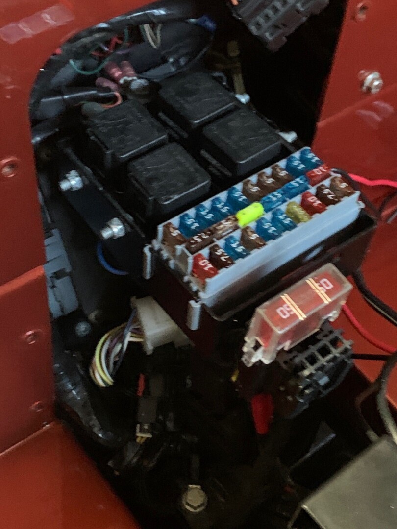

Here is a link to a photo of mine - does that look normal (specifically the connector forward of the fuse box) look normal?
Thanks, Tim

The block in front of the 50A fuse is not standard.

That would explain why the cover is missing. Now to find out what it is…..

Tim, the base socket the 50 amp fuse is located in are just modular sections that slide together, so if it's not connected to any cables below it's easy to get rid of

Looks normal to me. The large fuse holder accomodates main battery fuse.
Richard - there is an additional connection block fitted in front of the fuse in Tim's picture.

Thanks for pointing that out Steve and apologies for missing it. The connector looks like one shown in parts book diagram above for external LED flasher relay. Strange thing is though Tim's car is a 2015 build and it was after August 2014 that the newer 18 pin TSM unit was fitted that incorporated the flasher function, so no need for external one confused2
Either way maybe Tim could confirm if the connector could be moved, assuming it presently would foul the standard cover used on all models. As Jon suggests it appears to be just clipped/slipped onto main battery fuse holder.
