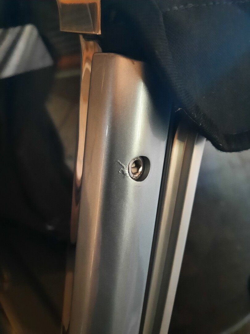

Our Plus Six started the corrosion when 2 yrs old on both sides. Repaired under warranty. The dealer informed me the original screen fixing holes are made too small, so after initial painting when the allan screws are inserted the Allan heads rip the paint off as they are tightened.. See photo. The leading edge of the screws Allan head is tight to the front where the corrosion started. The answer is to enlarge the hole around the head and repaint.. I also push in around the allan head sides clear vaseline or similar to help stop water ingress.

Phil Ledgerwood sold chromed A posts on an exchange basis around 2009, but the finish didn't hold up over time so they were discontinued. The Allen bolts just need removing and apply your favourite "solution" whether that be Coppaslip, ceramic grease, Vaseline or whatever. Then just watch closely for the merest hint of corrosion. The finish on those A posts varies. My 2005 has an almost Hammerite look, which may or may not be original. It hasn't shifted in 19 years. My 2016 has a sort of battleship grey semi gloss finish. It's still OK after seven years despite the worst Scotland could throw at it.
