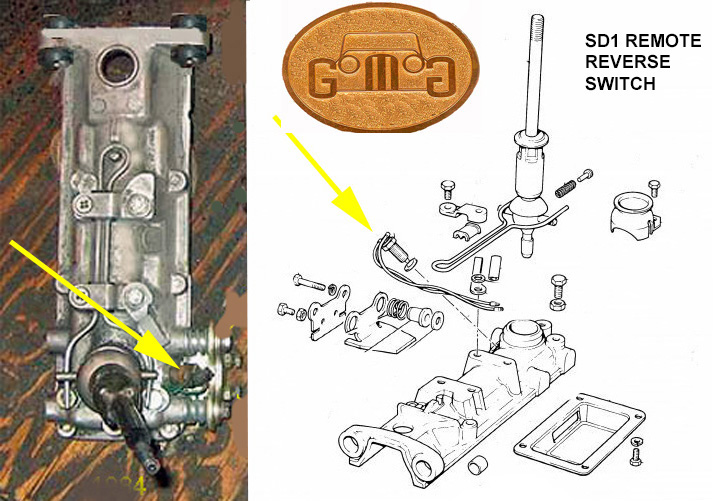

1. Normally, a reverse light problem turns out to be the ground (very common) or bulb (s)..whether you have a LT77 or any other gearbox. However, the two wires from the switch can conceivably fail for some reason. I have only once heard of the switch itself failing. I believe the current part # is TKC6761 (P) but it has changed many times, this number being the latest aftermarket fit. It is not installed in the gearbox, but rather the Sd1 remote that Morgan LT77s and R380s use. It is about 25 quid in the UK and 50+ in the US or Canada. It takes about 5 minutes to remove the old one and install and wire in the new one.
2. The problem is access. It is MUCH easier to build a car than repair one. Cars are built by adding many things on top of each other. Cars are repaired by accessing a lower layer. Like many automobile manufacturers Morgan made a mistake in this area and it has lasted for generations. I imagine it is a factor in the CX cars. At the juncture of the gearbox and propshaft covers, instead of having the flange of the gearbox cover rest on top of the other, they reversed that. That forces one to remove/reinstall the seats, the carpets, the propshaft at the rear bulkhead, the propshaft from the floor, merely to lift the gearbox cover to do a variety of 5 minute jobs that will be necessary over the lifetime of the Morgan. That adds 5-10 hours work, depending on the number of people, expertise etc. Expect to do it many times.
Of course, the cognoscenti (dealers, gurus etc) will not have any of this nonsense. We made jokes about it. But it breaks my heart to see the suffering and money such a simple mistake it costs us owners. I altered my cars decades ago. And I recently canvassed my dealer friends and found they have done the same. We have all been quiet about our mods as many moggers will not alter their Morgans, een to make them better, though we are now in era where the same people spend thousands doing just that with all sorts of mods!
Here are various examples of what we have all done. In all cases, the mods take a small fraction of the time removing the seats requires. https://www.gomog.com/allmorgan/GearCoverTweak.html
I attach a diagram of the actual job. Not to worry, there are 3 variants of Sd1 remotes, I merely chose one of them. Aside from the better gear lever bias and ease of shifting adjustments on the one shown, they are all the same. Btw, once you are in the area, there are great things (simple) you could do to improve your Morgan. I have a gomog law that any repair should also incidentally improve the car at the same time.
