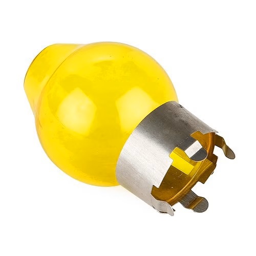

Just like my headlight LEDs they'll live under these yellow glass globes.
When the fogs are off this will give the correct golden glow the original Marchal globe style yellow bulbs produced back in the day.
