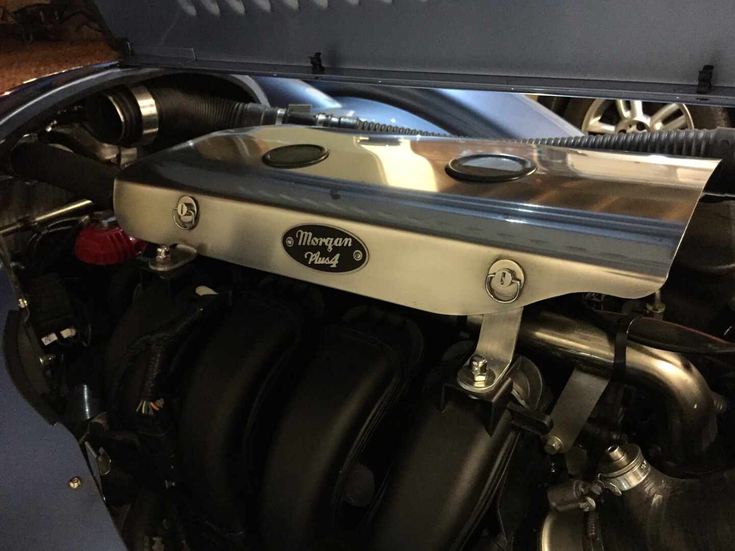

Not aware of anything available to purchase but several good folk on here have fabricated their own.
There are several ways to secure the plate. I opted for aluminium upstand brackets bolted to existing items on the engine and the intake. The aluminium cover plate was fixed to the brackets by QD dzus fasteners,
1.5mm cover plate was hand bent over timber formers in a workmate bench. A stiff cardboard template is a must to get the desired shape before cutting any metal.
Pics below show what I ended up with.
Hope this helps.

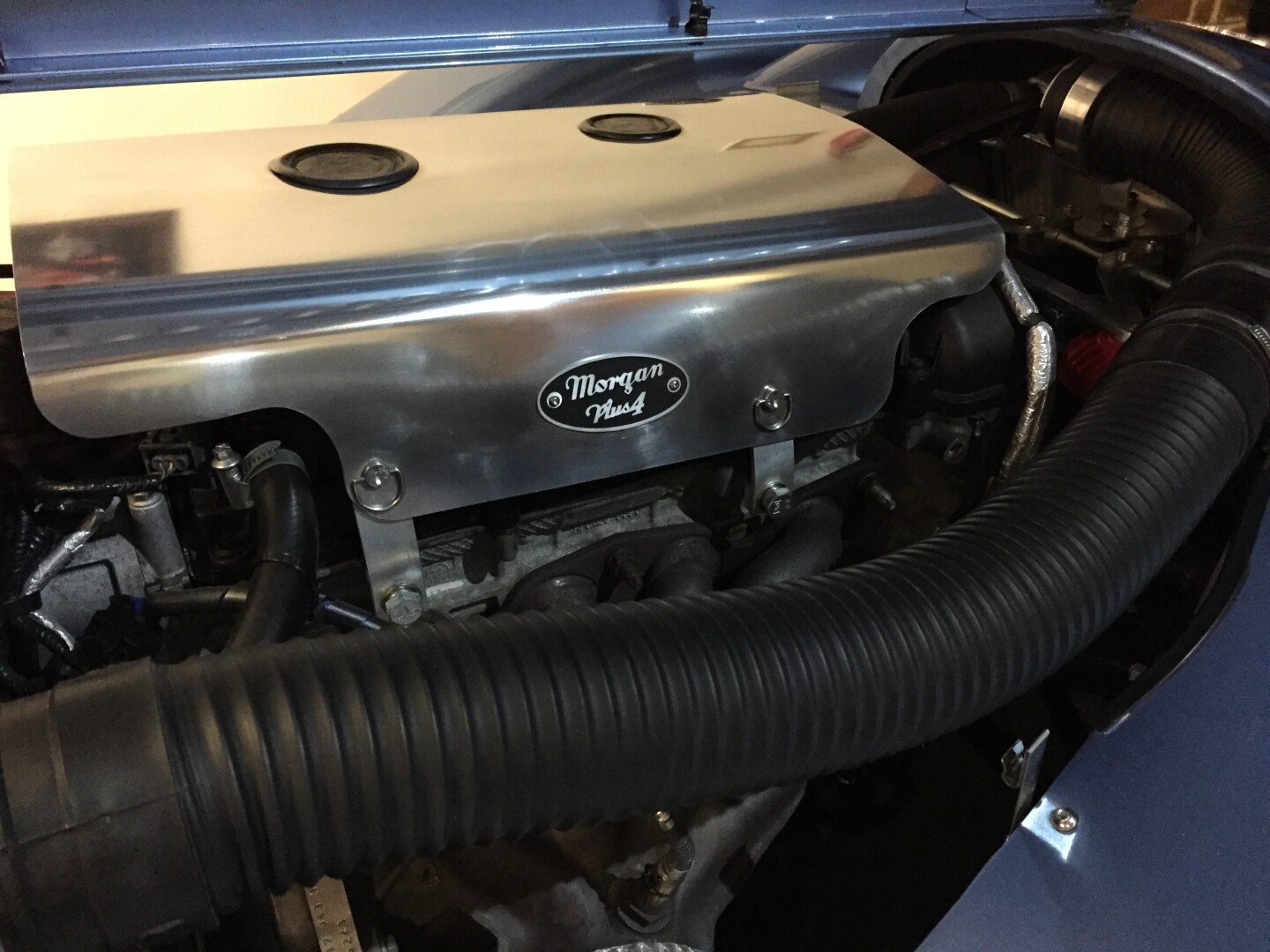

A thread here Ian on another home made one as below.

Ian this is the one. A lot cheaper to knock one up if you have the right facilities to hand.

Thanks for posting the pic of the engine cover Richard, very tidy, though I wonder if it restricts cyl head cooling as it looks to perhaps affect airflow and the alloy would seem likely to retain and radiate heat to some degree... Hmm..? However if that fixing system on the exhaust is a standard Morgan fitment it seem the MMC have well exceeded Porsche standards, as the manifold fixings on water cooled Porsches are abysmal, and a well known problem area some years down the line if removal of the exhaust is ever required... swear
Posts: 22,370
Posts: 22,370
The manifold mountings are "standard" (flat plate) but the manifold looks either AR or Librands.
Head cooling is always going to be the imponderable. I left a gap on my cover of maybe an inch and a half, and didn't wrap the sides down. Also painted the underside matt black, and it's no problem after a few years.
