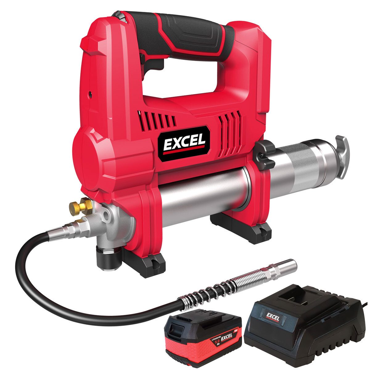

With a birthday imminent a generous swmbo has provided me with an electric gun.
A little OTT maybe but it takes grease cartridges allowing cleaner less frequent re-fills. A recent greasing session took barely a one second squirt on each nipple on minimum flow setting. Just added one of those clip on q/r heads as well.
