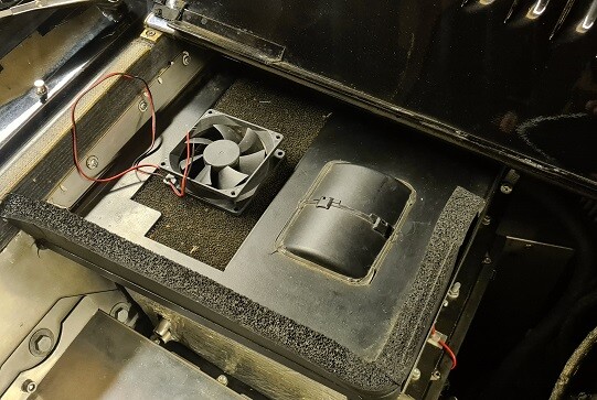

If the issue is just the heat from the heater matrix heating the cockpit or soaking into the cockpit on a hot day, perhaps you could engineer the system to also work in reverse. Maybe mount a couple of large fans (larger than shown) on a manifold plate in the space above the heater box, one either side (or even a bank of smaller fans). Then with the heater flaps open you could draw ambient cabin air back through the matrix, taking the heat up and away out through the bonnet louvers.
Obviously you couldn’t use both fans together.

A good though Rog. My guess (yes, guess) is that a couple of those fans (scavenged from an old desktop PC?) might be needed to give sufficient airflow. Back pressure from the louvres near the windscreen might be a problem with insufficient fan piwer.

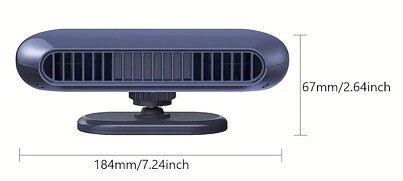

Howerver it might just be possible to recirculated ambient air within the cabin, if you were prepared to sacrifice the radio space. You could always mount a bank of PC fans across the radio aperture to stir the air. That would pull in ambient cabin air from the existing heater box outlets and blow it forward. Little risk of warm air being pulled through the heater matrix as it would most probably just short circuit, pulling air from the least line of resistance through those outlet vents.
You might even be able to mount something like this in the radio aperture, although might not be so powerful.
PS – Do you really need a radio in a Morgan. I’ve never ever used mine grin2
